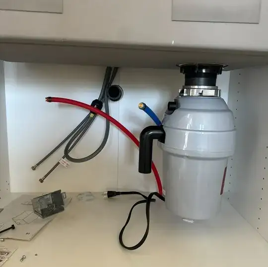

Is the height of my drain going into the wall too high and I’m screwed? What should I do?kitchen drain
Yes with a drain at that height you will always have water in your disposal.
Either go without a disposal, or have the drain lowered.
A last suggestion that is probably the least popular, is a sink that is not so deep.
I know of no disposal that has a discharge port that high on the unit.
