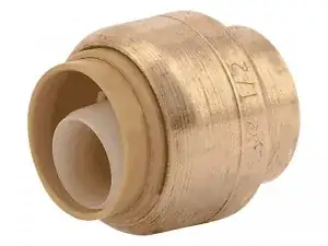

For peace-of-mind you could consider a SharkBite push cap:
SharkBite half-inch Brass Push Cap
It can be used instead of or in addition to the shutoff valve. When you're ready then just remove it.

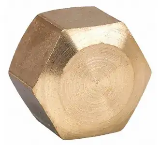

There is one caveat I would add to this: cap the unused connectors.
Brass cap
You'll spend a few bucks doing this, but there's two problems with just leaving a shutoff valve sitting unused
  1. You allow trash in. It's hard to clean the valves if they get dirty, especially if you're going to do more work later.
  2. You prevent any leaks (or worse) if the valve gets bumped.
