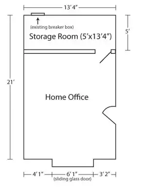

I am currently in the process of planning a room remodel to convert an existing bedroom into a home office and storage room. One thing that makes this conversion a little bit tricky, is the existence of a breaker box at the rear corner of the room.
As you can see in the image below, we plan to have the back 5' of the room become a storage area (there would be 2' deep shelving units along the back wall, stopping short of the breaker box, we would use this area to store Christmas decorations, misc. stuff, etc..). I know it is illegal to place a breaker box in a closet that will store clothes or other combustibles. So my questions would be: 1) how would one define a storage room vs. a closet (i.e.- could this be classified as a walk in closet somehow?) and 2) with > 36" clearance in front, and 30" around, would this be legal?

Which means the equipment can be in an area used for storage, but the Working Space cannot be used for storage. The basic idea is if you draw a box on the floor in front of the equipment 30" wide and 36" deep, and then extend that box up 6 1/2', you'll have your "Working Space". As long as you keep this Working Space clear, you should have no problems. However, there are a few more things to consider.

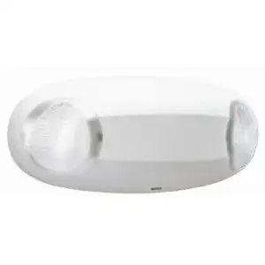

It's a good idea (though a bit overkill), to also provide emergency lighting near the equipment. Installing a simple fixture like this near the equipment, ensures that you won't have to fumble in the dark to flip breakers if the power ever goes out.
This unit can be installed on the same dedicated equipment luminaire circuit. That way even if you have to switch off the whole panel to do work, you'll still have light.

Could you split the storage room space so you have a dedicated room for the panel, with a wall outside of the required clearance, and then have the rest of that area be the storage closet?
