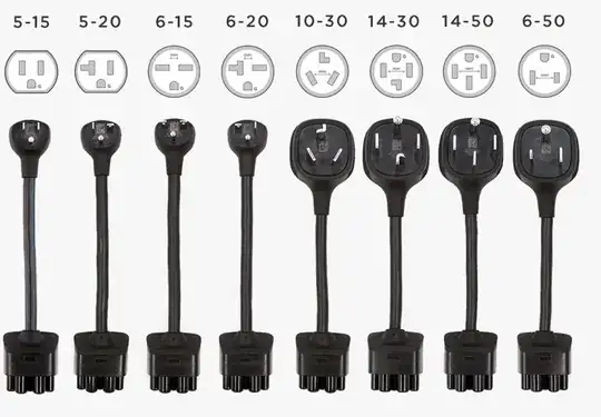

How do we get other 'speeds' on a travel EVSE?
Like this if your travel EVSE sells other dongles.
See, each dongle plug has a microchip inside. The microchip says "Hey, I'm a 30A plug!" and the EV says "OK, I'll draw the right amount of current for that". EV charging is slick. So if you install a 20A circuit just install a 20A socket and order that dongle plug. Easy peasy.
