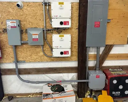

  • I have a 16kW solar array that is on the roof of the shop, but not directly attached to the shop electrical panel.

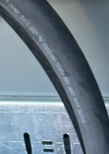

  • The wire from my meter to the shop is labeled ENCORE WIRE CORP 500 KCMIL AA-3003 AL
  • The shop is ~400 feet away from the main panel
  • The breaker at the main panel for the shop and solar is 200amp, but the shop panel itself has a 150amp breaker
  • The solar system that is connected has a utility mandated disconnect which has a 100amp fused disconnect.

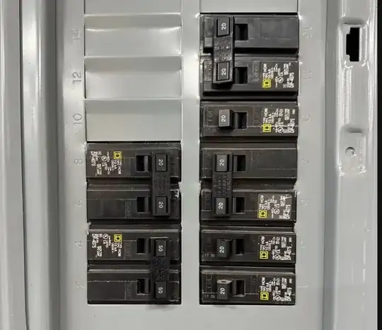

Existing loads on the shop:
  • A whole bunch of outlets (Served by 2 double pole 20amp breakers), in practice not more than one is used at a time
  • A 15amp breaker feeding a hydronic heating system
  • A 50amp breaker feeing a whole bunch of outbuilding sub panels

Wire to shop panel
Wire to shop panel

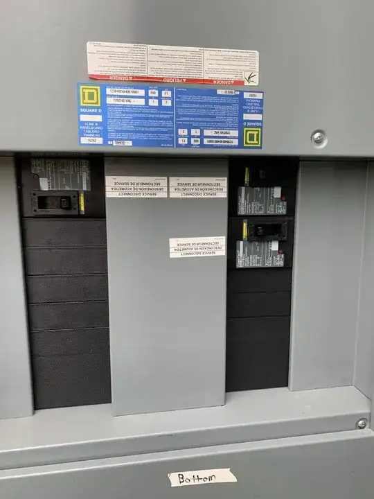

Shop Subpanel
Shop Subpanel Shop Subpanel breakers Shop Subpanel label

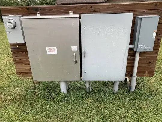

Main Panel
Main Panel Main Panel Breakers

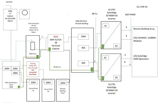

One Line Diagram from solar install: (Should hopefully clarify a few things

The solar is a monkey wrench. Something must be done to assure on a max solar productive day, the loads inside the panel don't overload the panel. Imagine a 200A panel with 100A of solar going full tilt. What prevents the loads inside the panel from pulling 300A? Nothing. So this problem is moderated by saying "If the utility supply and solar are on opposite ends of the bus, then their breakers can sum to 120% of the panel's bus rating". I know this is complicated.

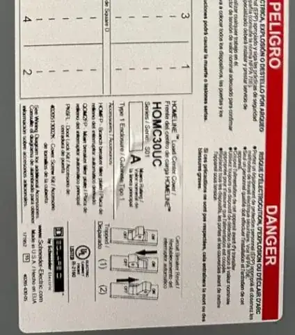

The HOMC30UC has a 200A bus (not 225A). 120% of that is 240 amps. So the main supply breaker + the solar breaker can sum to 240 amps if fed from opposite ends of the panel. What do you have? 150A supply breaker + 80A solar = 230 amps. That's why the 150A breaker; it was their attempt to comply with the 120% rule. But they made a mistake IMO.
The 400 kcmil wire can certainly handle 200A. So this limitation can be removed by having a "mini panel" with a 200A breaker coming into it*, then solar breakers ONLY in this panel, then a 200A breaker exiting it*. With no loads in this panel - well, work it out. Try worst-case current flows in all directions, it really can't go wrong.
* I'm saying it like that, because it doesn't really matter whether the 200A breaker is inside this panel, or at the other end of the feeder.
That's exactly the situation you describe in comments: "The wire from the main panel comes into the shop building, then splits off (Polaris connection in the large gray box at bottom) into the 100amp fused solar panel and the 150amp sub panel in the shop serving the loads."
I see breakers on all 3 sides - a 200A at supply, a 100A on the solar, and a 150A on the shop panel. I see no reason you can't enlarge the shop breaker to 200A - but it does need to have one for this to work.
So we have gained 50A of Load Calculation inside this panel by deleting the solar penalty. I don't know how much that'll help with the overall Load Calc in this panel because you say other subpanels also come off this. So you'll need to evaluate that, you're looking at the Load Calcs not me.

Based on the transformer capacity I see 0% chance of successfully installing this thing without talking to the power company to figure out whatever needs to be figured out at their end.

I think the electrician was wrong on this one. According to the Southwire Voltage Drop calculator, 500 AL at 200A (and really you can only do 150A because of the subpanel breaker, and realistically should then be at 120A for continuous derate) is only a 4% drop. And at 150A, 3% drop. So as far as I can tell, that is just not an issue.
