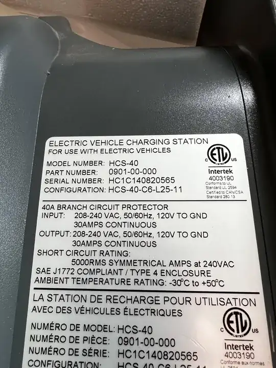

EVSE NPR 30A @240V: 7,200

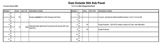

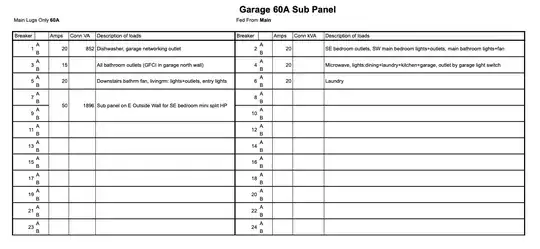

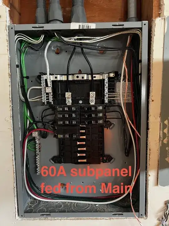

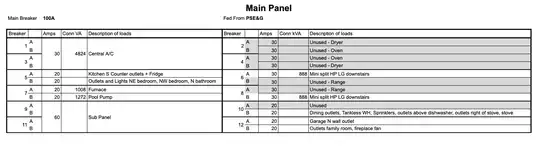

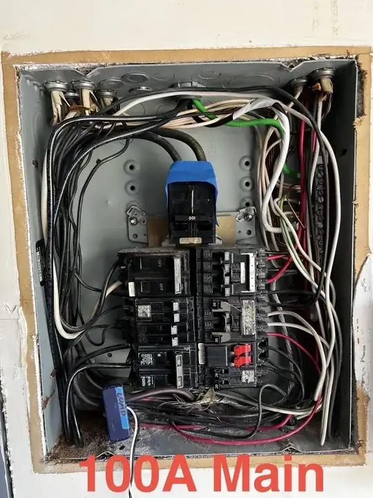

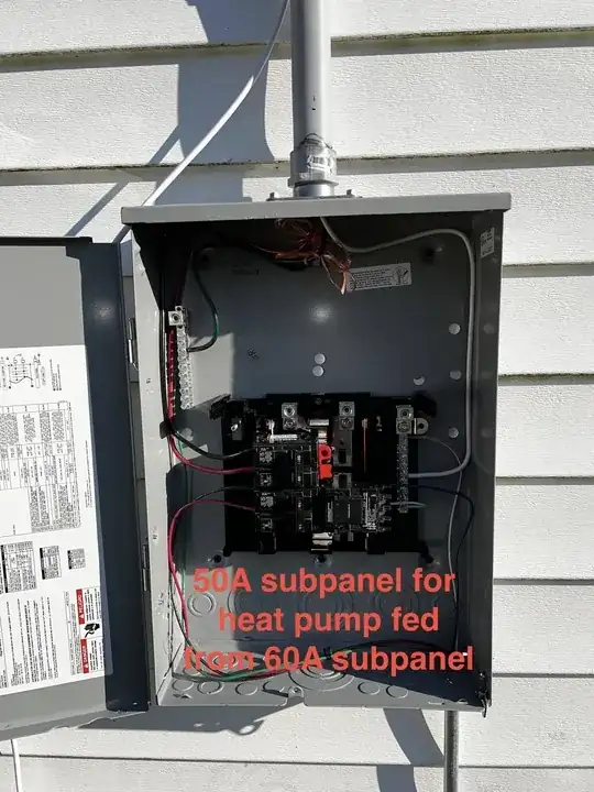

Edit: Here are some pictures. The EVSE breaker could either go in the main panel or the 60A sub panel. There are some unused circuits in the main panel: the quad in the upper left was for an electric range+oven that were removed. The middle breakers on the quad below it were for an electric dryer that has also been removed. The 50A sub panel for the heat pump could be on a smaller breaker. 100A main panel
60A sub panel
50A sub panel for Heat Pump
EVSE
Edit: Added description of all the loads on the various breakers. Main Panel Circuits description 60A Sub Panel Circuits 50A Sub Panel Circuits

First, correct some math on the EV circuit
EVs are deemed continuous loads and need a 125% derate as a result. Thus you get assuming 240V:
  • 15A breaker = 12A actual = 2.9 kW = 75-90 miles in 10 hours
  • 20A breaker = 16A actual = 3.8 kW = 100-120 miles in 10 hours
  • 30A breaker = 24A actual = 5.7 kW = 150-180 miles in 10 hours
  • 40A breaker = 30A actual* = 7.2 kW = 190-225 miles - a very few EVSEs such as Siemens Versicharge are actual 30A, wasting a few amps on the 40A breaker. (Pointy Haired Boss?)
  • 40A breaker = 32A actual = 7.7kW = 200-250 miles in 10 hours (gosh!)
Speeds above this are just bonkers. Most people grossly overestimate how much power they really need, and/or get swept into "50-amp thinking" because of a certain misconception.
ClipperCreek does not make a "30A actual/40A breaker" EVSE. The HCS-40 is 32A.

Now typically, the EVSE's are advertised as the breaker value and then their true charge rate is 80% of that. ClipperCreek is no exception. They don't make a "30A actual, 40A breaker" EVSE. This is flat wrong for a Clipper Creek HCS-40.
I do note that your Load Calc does work with the fake 30A number and doesn't work with the true 32A number. This leads me to a certain skepticism.
Unfortunately, Clipper Creek units deny you any way to jumper to different ampacities, otherwise I'd say "jumper to 24A and don't worry about it". Not a fan of the brand because of that. Honestly given your load calc and the fact that you could get a 16A or 24A unit in there with room to spare, I would have recommended a smaller unit instead of a service upgrade. Doing unnecessary service upgrades is practically the #1 blunder made by novice EVers.
Honestly you may be better researching Federal, state and local incentives for wall-unit installations, and see if you aren't money-ahead selling the HCS-40 on Craigslist and then buying the right unit with pro installation with incentives.
I'm sorry you made a purchasing mistake but it seems like you're going to extremes to try to salvage it. Just write it off as tuition from the school of hard knocks: don't impulse-buy technical products.

What I would do
I don't like unnecessary service upgrades. It's obvious that your house is slowly transitioning away from inefficient A/C units and to highly efficient heat pumps one section at a time. I expect that to continue, your service needs to decline going forward, and upcoming smart-breaker tech will only make it easier to fit stuff on limited services. Yours is a good example of a house that may never need a service upgrade.
Mind you, I am not burdened with an emotional need to salvage an unfortunate purchase.
So my winter configuration for your house would be to disconnect the A/C entirely - pull the wires off the breaker. It is now off the Load Calculation. If I could get a wall unit EVSE that is jumperable for different ampacities immediately I'd just do that, otherwise I'd get a 30A dongle for your travel unit, and wire a circuit to power it.
"30A" (actual 24A) charge rate should ease your winter charging anxiety.
By spring, I'd reconnect the old A/C and jumper the EVSE down to 20A. Shouldn't be a problem, just keep an eye on it. If it is, DC fast charging can always cover the gap for those "but sometimes" moments. The next fall, I'd try leaving it at 20A and see if 20A winter charge is sufficient. I bet it is.
