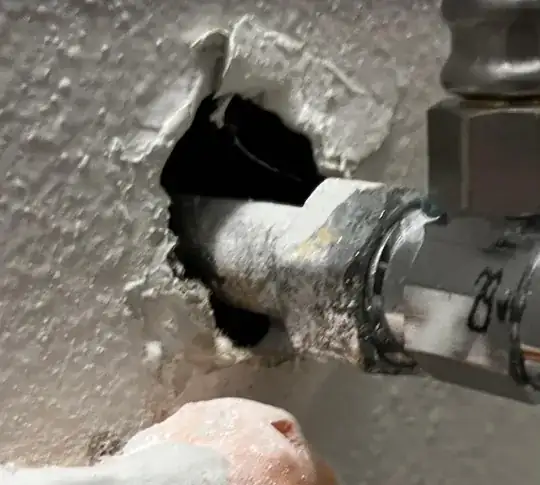

What’s the best way to fix drywall holes ~1-1.5” on each side around pipes coming into the wall under sink. I’ve seen folks foam the holes around pipes, but it looks ugly. I was thinking to patch with spackling patch, but this would most likely crack if any force is applied to the pipe to connect/ disconnect faucet etc, or by accidentally impacting the pipe under a sink. ‍♂️

Sounds like you want a escutcheon, which is a metal (usually) trim part designed to cover the hole between the pipe and the wall.
I generally just put some mesh drywall tape and hot (setting-type) mud (joint compound, not spackle) there, if I'm going for "slow down the mice" rather than "pretty." For "pretty" you want a escutcheon. If you have the pipes already in place, you'll want a hinged one that does not require disconnecting pipes to get it in place.
HVAC duct sealant will be the easiest and it is paintable and flexible when dry. I wish I discovered the stuff much earlier in life. I would use that with fiberglass tape.
