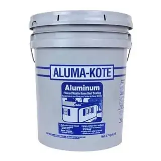

Fibered (that is, it has reinforcing fibers in the mix that help it to bridge small gaps) aluminum (fine flakes of aluminum that float to the top of the wet paint and dry in place to protect from ultraviolet light degradation) roof paint or coating is the default cheap roof repair paint for both metal and asphalt roofing.
Example of fibered aluminum roof coating from Ace hardware - no endorsement implied
Example, not endorsement. There are many, they are pretty much all the same, use what you can find locally.
Would it be better to use a more expensive product you can't afford - sure. And over a long time it might cost less. But I certainly know folks that probably applied this stuff every year or two for decades, and managed to keep the house sufficiently dry by doing so. And plenty of other folks including my family would use it as a stopgap for a few months or years before getting to a "proper repair."
