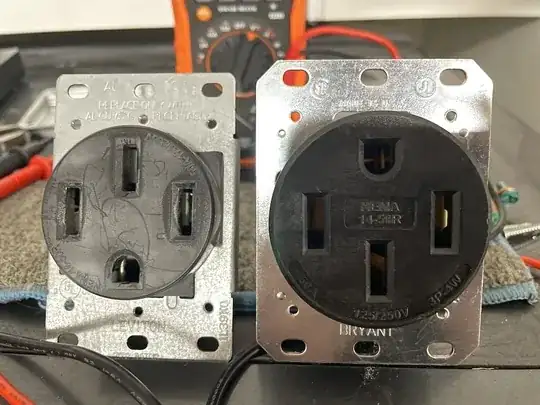

I have had the issue of my Tesla charger dropping down to 16 amps from 32 amps after 30 minutes due to high outlet temperature. Turns out the usual culprit is the crappy Home Depot special Leviton 14-50 outlets that get installed. They're weak, aluminum and copper, and can't handle sustained 240V 32 amps for hours on end.
I decided to upgrade to the highly recommended industrial grade Bryant 14-50. It's obviously of tremendously higher quality, copper everything.

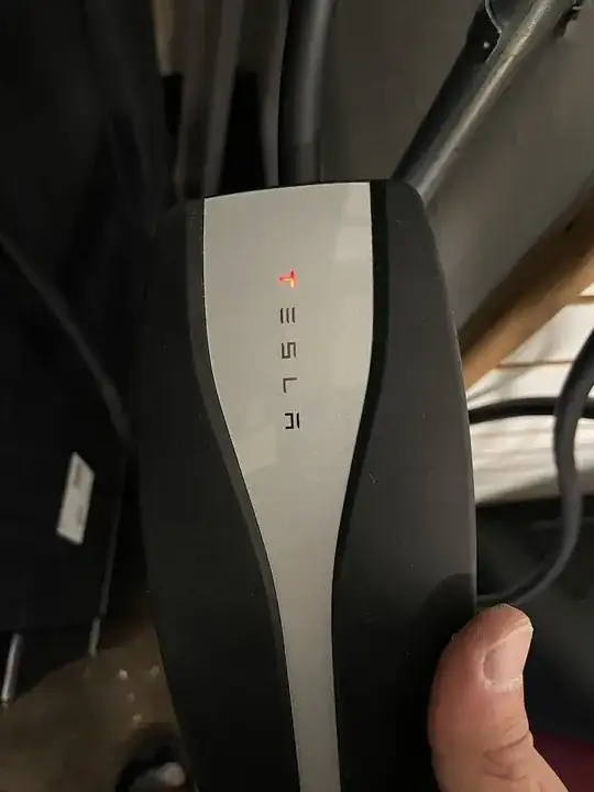

The one thing is... I can't get my Tesla charger to work with it. I get an instant red light on the T of the Tesla mobile charger. When I plug my multimeter into the left and right terminals, I get 230V immediately.

According to the Tesla Mobile Connector manual, no green lights and 2 flashing red lights = "Ground loss. The Mobile Connector detects a loss of ground."

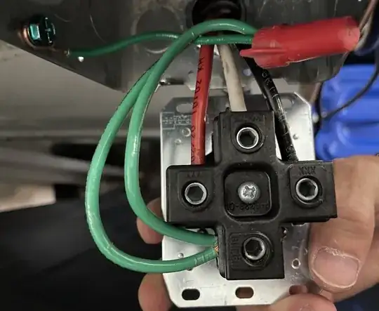

Here's my wiring on the new Bryant unit: enter image description here

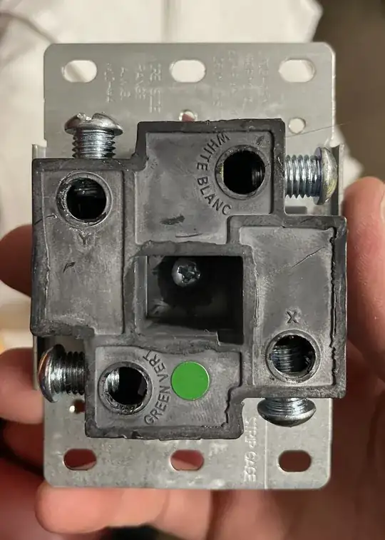

And here are the terminals on the old crappy Leviton: enter image description here

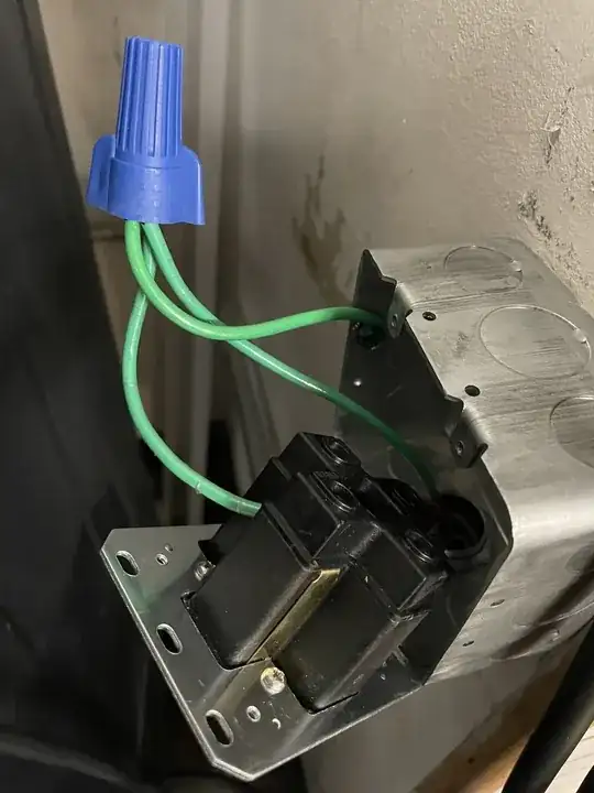

Made a proper ground this time. Same AWG wire all throughout. Found a trick on YouTube to make excellent connections, so I did just that... wrap the freshly stripped wires together at the end of the insulation with electrical tape to get them wrapped up with all the exposed copper leads tightly bound together, then take linesman's pliers and twist and the strands together gradually and slowly, until they've basically made a single large stranded wire. Then compress at the base, and clip the top edge to even the wire out. Then wire nut it together.
Got my in-lb torque wrench in today, and accurately torqued each lug down to 75 in-lb's as per spec by Bryant/Hubbell.
Still have the grounding error on the Bryant, and still have a happily working Leviton.
Hubbell unit comes in tomorrow, which will be a quick swap. With the count of people who had issues with the Bryant on my reddit thread now up to 5, I'm hopeful it's just a bad unit and the Hubbell will fire up once swapped out.

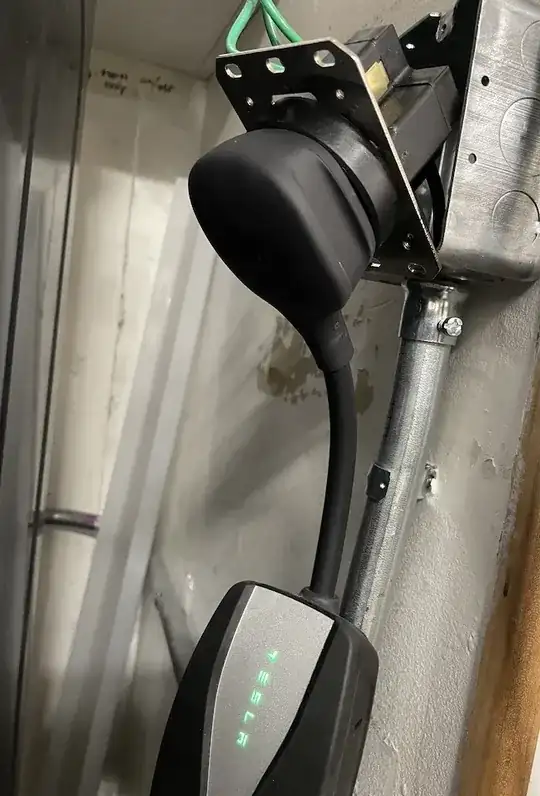

Please ignore all the extra wire and the hanging receptacle, at this point I'm just wiring it like it's on a test bench. I would obviously clean this up a lot before finalizing the installation. Just showing the new ground pigtail.

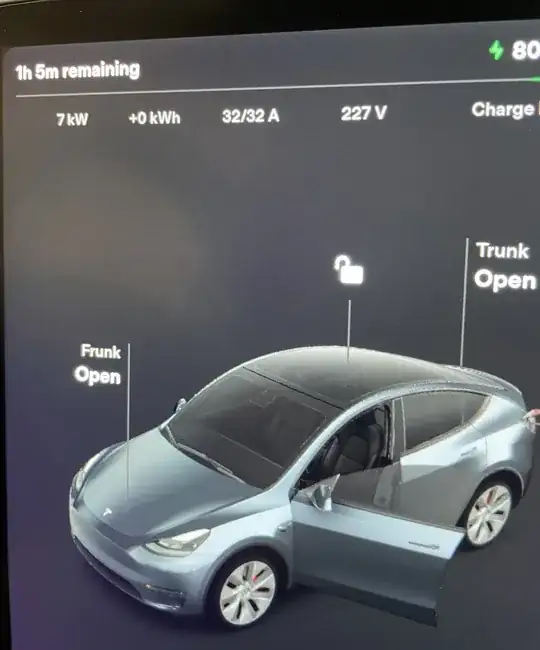

Uninstalled the Bryant, installed the Hubbell, torqued to 75 in-lbs, fired up the breakers, tested the lugs with the multimeter for voltage, plugged in the Mobile Charger, and boom. No ground faults, 32 amps of charging with 2 hours so far running way way cooler (tested with my thermocouple) vs. the Leviton, no issues with the Mobile Charger thermal throttling like the Leviton.
So there's a datapoint for anyone wanting to retrofit out the inferior consumer grade Leviton to an industrial 16-50. Get the Hubbell 9450A right off the bat, don't bother with the Bryant.

(To be clear, obviously you should never leave this install as in the photo. I've been running it like this with the breakers within arms reach during troubleshooting mode. The ground will be shortened, cleaned up, and everything backed into the box and a faceplate installed.)

Harper's Rule: when something doesn't work, and something else is improper/not right/not to Code, no matter how totally unrelated it seems... fix it anyway - it often cures your problem.
In this case, the ground wire to the receptacle is improper. Correct the issue with the ground wire.
Note that the supply wire must go to a metal box first. In many cases, ground will automagically be delivered to the socket via hard metal-metal contact with between steel box and metal receptacle yoke.
I suspect you are doing your testing with the receptacle not physically mounted, and so that passive grounding is not happening. It's falling over to the hokey ground and that's not working.

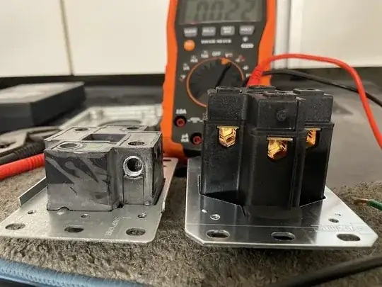

Occasionally Bryant/Hubbell 14-50 outlets have misshapen ground internal terminals. Non-ideal QC. This can lead to open ground faults. You can check the ground terminal by inserting a 17/64” rod/drill bit into the outlet’s GRD hole and feel for slight drag. A 9/32” rod will require a firm push to pop in and will have significant drag. Reminder to power off first.
