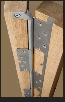

Consider using barn door hinge stile
or continuous hinge stile for heavy door
or use 3/4 inch plywood cut to size of the door, hang it with hinges and mount the book case onto it
hinge

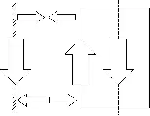

You have two structural problems
First problem
![enter image description here
The vertical stud that supports the shelf is subjected to lateral forces, but was designed to resist vertical forces.
If the arm of the hinges were ~2m and the shelf were very large, say 1.2 m, with a full mass, DL+LL, of 150 kg the horizontal forces are in the range of 0.5÷0.6 kN, that the stud should be able to support (note that, as the door turns on the hinges, the direction of the horizontal forces change wrt the plane of the wall).
To err on the safe side, use two couples of hinges (or some specialty hardware), and mount them on a longish steel plate connected to the stud — the problem with horizontal forces on the shelf side is not relevant because the hinges are connected to a 2D element, very stiff in its own plane.
Second problem
The back panel is very stiff in its own plane, but when subjected to a compressive force is prone to warping, and it is indeed subjected to a diagonal field of compressive stresses. Will it warp?
To err on the safe side, we have different options, not mutually exclusive…
  1. use a thicker back panel,
  2. glue/nail ridges in the direction of the principal stress of compression (approximately SW-NE in the drawing),
  3. screw the shelf planks(?nmt) to the back panel.
I prefer no. 3, but you may want to move the supporting planes inside of the shelf.
Of course the stud is subjected also to forces perpendicular to the door plane, because it's not a door, it's a shelf and the centre of mass is some 20 cm away from the back panel, but those forces, due to lower eccentricity and the square root of the sum of squares, cannot change very much the resultant horizontal forces.
