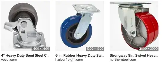

56 nylon ball casters, each rated to support 3kg static (or 5kg dynamic), will they durably support my bookcase (~135kg fully loaded)
WOW, that would be quite a job installing 56 casters!
Instead I would use heavy duty casters. For example they are used on toolboxes and they can carry 300 kg each so you only need four of them plus the wheels can be large enough to overcome any floor issues.
casters
They come in different sizes, just pay attention to the load capacity per caster, and you will need swivel type since you are rotating the book case in a half circle.
Additionally I would put the framing around the bottom part of the book shelf just above the floor to hide the casters.
