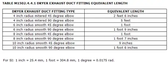

M1502.4.4 Duct length. The maximum allowable exhaust duct length shall be determined by one of the methods specified in Section M1502.4.4.1 or M1502.4.4.2.
M1502.4.4.1 Specified length. The maximum length of the exhaust duct shall be 25 feet (7620 mm) from the connection to the transition duct from the dryer to the outlet terminal. Where fittings are used, the maximum length of the exhaust duct shall be reduced in accordance with Table M1502.4.4.1.
Table M1502.4.4.1
M1502.4.4.2 Manufacturer's instructions. The size and maximum length of the exhaust duct shall be determined by the dryer manufacturer's installation instructions. The code official shall be provided with a copy of the installation instructions for the make and model of the dryer at the concealment inspection. In the absence of fitting equivalent length calculations from the clothes dryer manufacturer, Table M1502.4.4.1 shall be used.
Basically what all this means, is that in general the overall length of the duct can be 33'. 25' of the duct system; measured from the exhaust hood to the dryer connection, must be 4" rigid metal duct. You can then have an 8' section of "transition duct", which can be flexible duct, but must be UL listed and labeled for the use. For each elbow, subtract the value from Table M1502.4.4.1 from the overall 25' length.

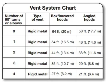

If you look at the Maytag installation instructions (PDF), they tell you what type of exhaust hoods you can choose from.
Exhaust hood choices
The instructions then provide a table to determine the maximum duct length, based on the hood used and the number of bends.
Vent System Chart

Smooth duct will help. Fewer 90 elbows will help! (each 90 elbow is a 5 ft equivalent). The reccomended (maximum) 35 ft unassisted duct run gets eaten up quickly by elbows. Even using 2 45s would help
