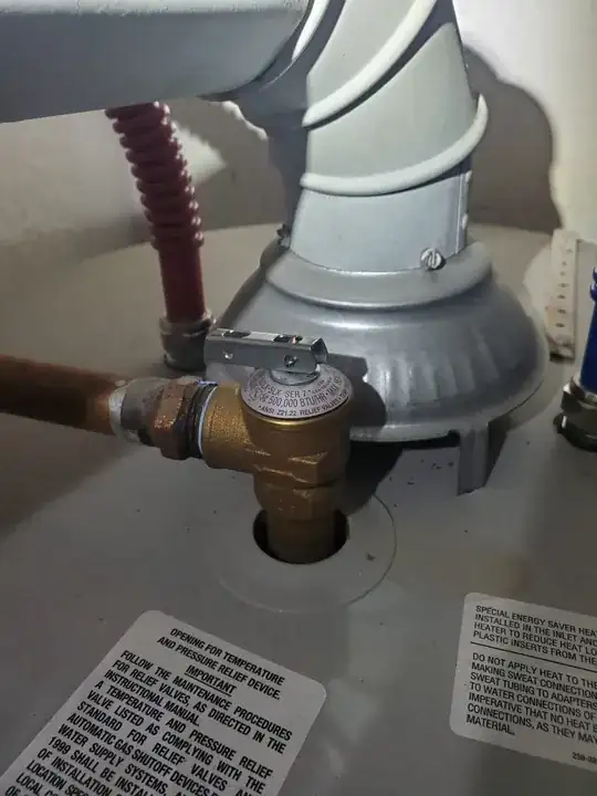

Update Pics of my TPR.

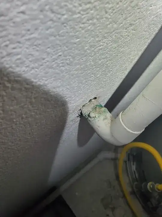

And it looks like where it connects to the wall is leaking. Any idea how to fix that leak. Is that solder?

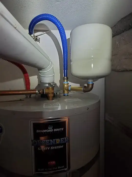

Presumably your water heater already has the standard temperature/pressure release valve installed (which will typically be set at 120-150 PSI for pressure) so what you need is an expansion tank - that goes anywhere on the cold water supply between the PRV and the water heater.
Or anywhere it's convenient on the cold water supply after the PRV, really - if you don't have any oddball check valves that would not be typical, the entire cold supply is connected, so the expansion tank will work anywhere on it.

I forced my water heater into heat mode by increasing the temp to the max setting, and I confirmed that in fact the water heater was in fact causing the water pressure to rise
I watched this YouTube video as the blueprint for my installation: Expansion Tank Installation on a water heater - What is an expansion tank? - How to install it

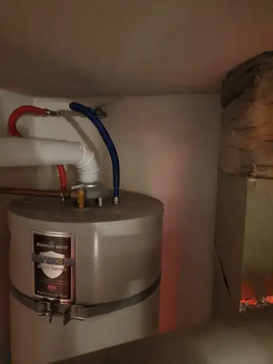

Before/After: enter image description here enter image description here
After installation, I no longer observe the temperature rising due to water heater heating.
One thing that I did when I was refilling the water heater w/water after installing the expansion tank was to leave the TPR open to let air escape. My logic was that I didn't want trapped air to put pressure on the expansion tank diaphragm and reducing the efficacy for the actual purpose of absorbing the pressure of the expanding water. Not sure this was necessary, though. But I did it.
