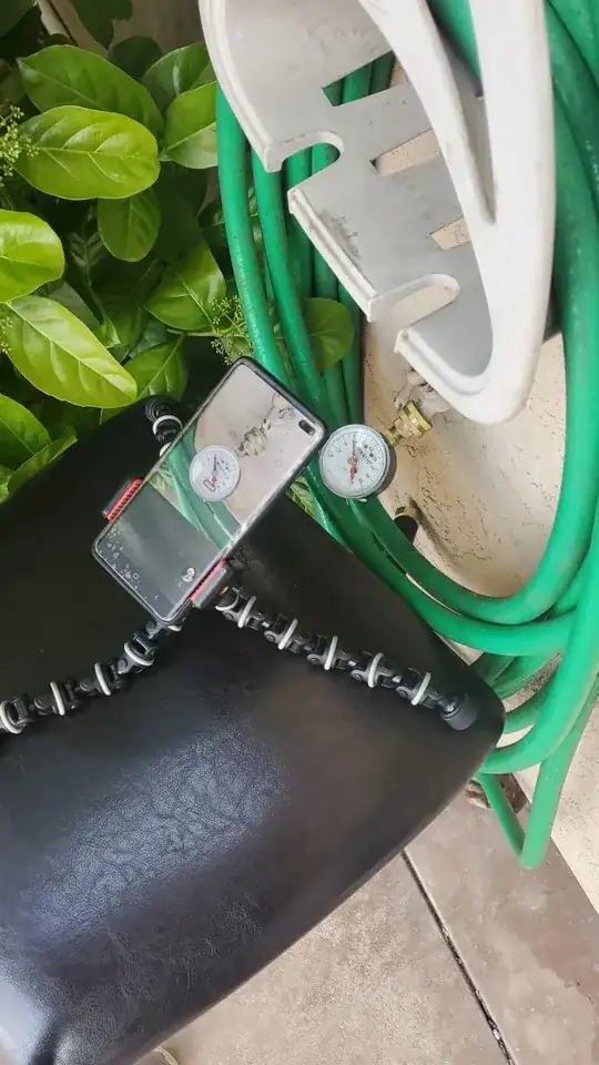

While working on the 2nd issue above, I set up a 2 way video call w/myself so I could monitor water pressure guage remotely enter image description here
I confirmed that flushing the Master Bathroom toilet spikes the water pressure up to about 110psi, but immediately after it drops back down to the 60psi where I set it.
Is this a concern? Will it cause damage to the water system associated with high water pressure?

It's water hammer. Add a water hammer arrestor near the toilet valve.

This was a false alarm.
After flushing the Master Bedroom toilet, the pressure hand on my gauge does kick back up to about 65psi, but it's the force of the kick that throws the red hand up to around 110psi which is why I thought the pressure was spiking up to 110psi.
Despite this, something is still intermittently causing the pressure in my system to rise and hold at 80-ish psi, and sometimes 100-ish psi. Not all the time, though. For example, the past hour it's held steady at the 60psi that I set the regulator, but then every so often, some combination of events causes it to rise and hold. Not the water heater that I can tell because I can hear that it's not in it's heating mode.
Not sure what it is. Will keep monitoring and report back when I'm able to reproduce it consistently.
