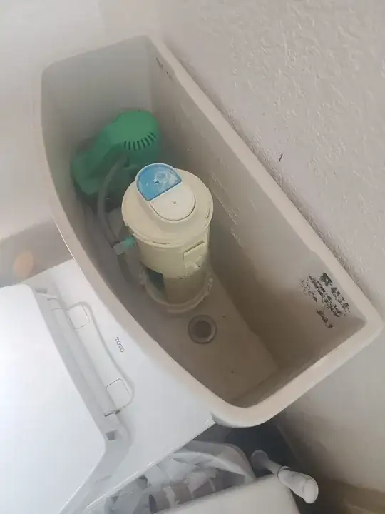

Here is a picture of the inside of the hallway toilet with Toto Aquia II Fill and Flush valve internals:
Flush Valve
Fill Valve enter image description here
The Downstairs toilet has different internals that I'll have to get a pic of later when I have access.
