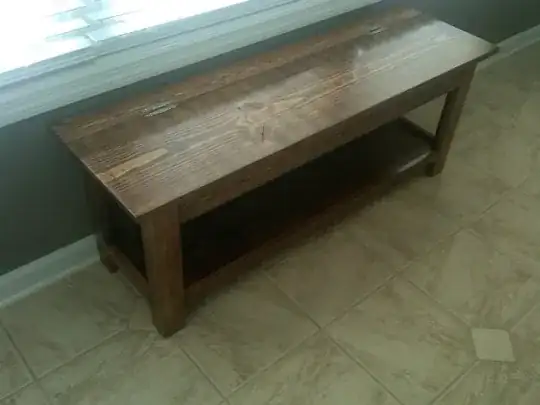

Update:
Here's the finished product! I finally got around to taking pictures of it. Thanks for all the advice guys - it turned out really well. I used a Minwax wood conditioner first, then a gel stain and then three coats of high-gloss poly, lightly sanding with 220 grit after the first and second coats.
