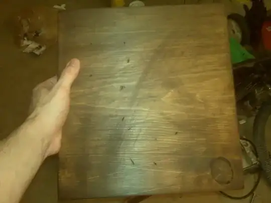

I did some test staining on pine scraps, and I ended up with a cross grain arc that's darker than everything else. Where did I go wrong? (Or is it just the pine?)
(Related to this question, as a follow-up. I realized I had already accepted an answer to the original, so this should be a separate question.)
I recently built a pine bench, and I'm trying to figure out the best way to stain it. My wife and I decided on Minwax Hickory Gel Stain because we wanted a darker finish. The Home Depot paint/stain department employee also recommended it along with Minwax Wood Conditioner for staining pine.
I applied the Minwax Wood Conditioner (oil-based) to a scrap 1x12, and then 15 minutes later I applied the Minwax Hickory Gel Stain (also oil-based) with a foam brush and wiped it off with a rag 5 minutes later. I noticed there was an arc of darker color going against the grain on the test scrap. Any ideas how this happened?
I made very sure that I sanded with the grain (by hand), starting with 100 grit, moving to 150, and finally 220. The only thing that I can think of is I wiped the sawdust away with a very slightly damp rag, without paying attention to grain direction. Then about 15 minutes later I applied the wood conditioner. Could the be the cause of the streaking? I'd like to figure out the cause before I move onto staining my actual project.
Also, I applied a second coat of stain 8 hours after the first. I let it sit for about twice as long before I wiped it off this time. I didn't notice much of a difference in color from the first coat. Is there something about gel stains that it doesn't matter number of coats/how long it's left on?
EDIT: Here's a photo (the streak starts in the bottom left and goes toward the top right): alt text The random little spots running in a line vertically are test distressing marks I applied, to see how they would turn out when stained.

Ditto on most of the previous advice, except that I've been working with pine for furniture/cabinetry I've built over the last 35 years and my routine is to use a 3M scrubbing pad (green type, like the kitchen) to apply any type of stain that I use; circular motion to apply it, straight strokes with the grain to finish up. Recently I have started using sanding sealer before staining if I feel the wood I'm using might have a bit more resin in the grain (newer wood from the lumber yard), or if the shade of the stain I'm using will show the grain more, i.e., dark walnut versus cherry. If the first stain coat isn't to your liking, you can gently remove the offending stain with mineral spirits and a rag, then do a second coat. Pine can be VERY forgiving if you take your time, and actually is much easier to produce an "antiqued" or distressed appearance. If you're not in love with polyurethane, try a Tung oil finish; I know I hear alot of groans out there, but I have pieces I finished with it 25 years ago or more that still look great. Good luck with your work!

Staining will highlight any imperfections in the wood. From the photo it looks like something has been wiped across the grain. That could be when you wiped the sawdust away or possibly if you wiped the stain across the grain.
Having a good surface to stain is pretty much essential as the stain will highlight even the smallest imperfections.

Looking at your picture (good pic btw) tells me that there was a previous scuff on the wood at several locations on the piece. Hand sanding an old or abused piece of wood will never remove enough material evenly enough to do a good staining job. You need to use a DA or palm vibrating sander with 100 or 150 grit first then step down to 220 grit or finer to be sure to remove all the cross grain imperfections. Once you apply the stain, it is too late to fix any marks, like I see in your picture. Gel stain is very over rated. It's only advantage is that it is water rather than oil based. Apply a good oil stain liberally , let it stand a couple of minutes then rub it in good with a stain soaked lint free rag to evenly distribute the color, followed by a final rubdown with a clean rag. This will give you the smoothest most even result. The piece in the picture will need to be sanded down to bare wood again and start over, it can't be improved by adding more stain etc. If you want to "distress" the piece, make your dents etc after you stain. If white wood shows in the distress marks, use a Q Tip and a little drop of stain to color the white wood. Good luck.
