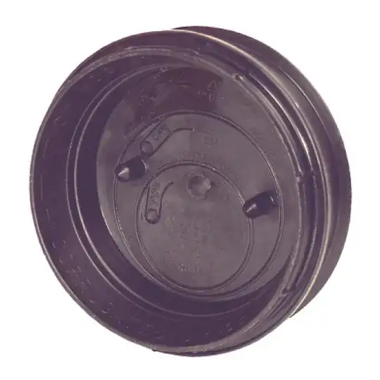

I've noticed some stoppers/plugs like this:
... but I'm not sure what they're called or where to buy them. I tried searching in my local big box hardware store and didn't see anything in the electrical section. I also searched amazon but must be using the wrong search terms because I can't find them.
Can someone tell me what the name of these stoppers are and where I can find them?

Caplugs is one company I'm familiar with.
These come from the septic tank industry

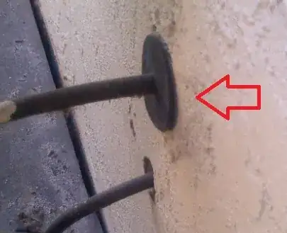

Apparently, you should:
  • use a wall grommet on the inside (like the one you have in the picture)
  • use a Roman nose on the outside with a drip loop to prevent water draining into the house
