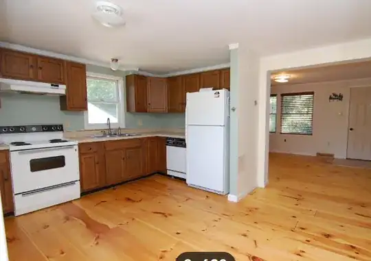

I'd like to buy a new refrigerator, one that's considered standard width of 35.75 inches. The space where my old refrigerator is to small by about an inch. I'd like to take down the partial wall that sits next to the refrigerator, but want to make sure it's not load bearing. It can be seen in the picture attached.
I know the wall that the partial wall attaches to is load bearing as it runs down the center of my house, and the joist in the basement run perpendicular to the center wall. The partial wall runs parallel to the joist.
My basement is below it, it's a completely open concept basement. The joists in the basement run parallel to that partial wall. That center wall in the picture is the load bearing wall, and is supported in the basement with a beam and columns. Above is a bedroom.
If there's no support (beam or column) holding it up from below, and nothing coming down onto it from above, it's not load-bearing.
