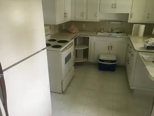

We are planning on redoing the kitchen, and we want to replace the electric stove with gas. Fortunately, it looks like the previous homeowners had a gas stove at one point and decided to replace it with electric. Unfortunately, the old gas line - which is valved and capped - doesn't end where we want the new range to go after the remodel.
Range is on the left currently

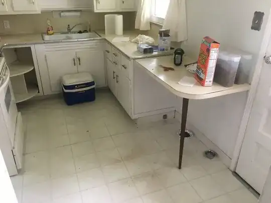

We want it on the right, next to the door

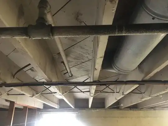

Range is currently on the left, we want it on the right, immediately next to the door - that's an external wall, which should make a nice range hood easier. Gas line looks like this:

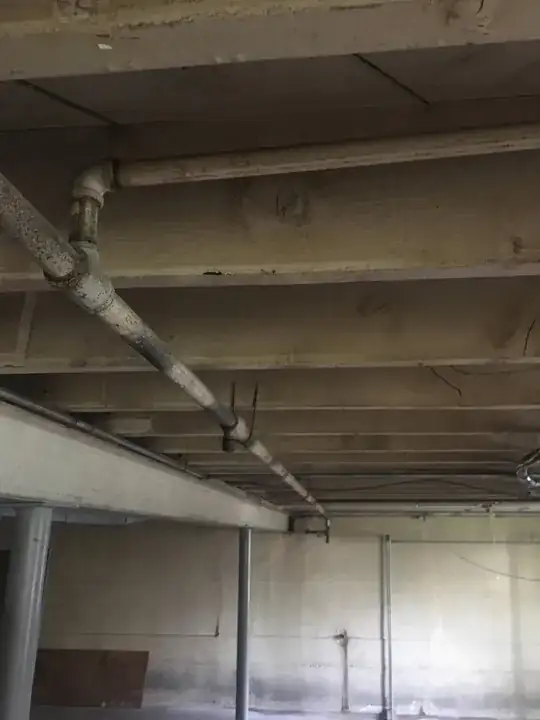

Gas trunk with start of branch for old gas range
Gas branch ends too early
The trunk has a branch for the range between what MIGHT be the right joists, but it might need to go one over (where the HVAC ducting currently is).

Leave the T-junction branch, the 3" vertical piece, and the elbow. Disconnect the straight piece from there, and get a longer one to run it out to to the far wall where the range will be positioned. The piece is currently 5' or so long, and it'll need to be about 8' longer - so I'd be replacing it with a 13' pipe. Elbow at that end and point a new piece straight up through the floor, then shutoff valve, then use a flexible connection between that and the range.
The alternative is to leave the 5' pipe in place, add a shutoff valve there, then add the 8' pipe afterward. This would mean I don't have to put the valve behind the range, but if I finish the basement (also part of the plans... eventually) then I'd need an access panel there in the ceiling which would look weird.

Your plan is fine, but you won't find a 13' pipe. Just add 8 feet to the existing 5' pipe (or use 10' and 3' pipes).
