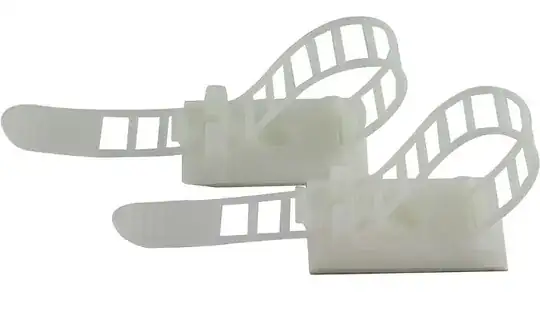

I would use these. enter image description here
You screw them to the joist with the cable out of harm's way. After that they are adjustable and reusable.
Doing a lot of nailing and stapling around the cables in a space that will see little to no future activity seems unproductive.
