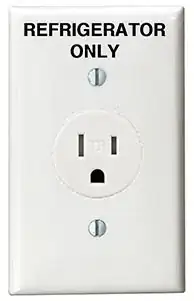

If the outlet is completely covered by the fridge (so not generally usable for other stuff), consider replacing it with a non-GFCI single-outlet receptacle and labeling it as "no GFCI". If nobody is regularly plugging things in/out, it reduces the likelihood of electrocution anyway.
