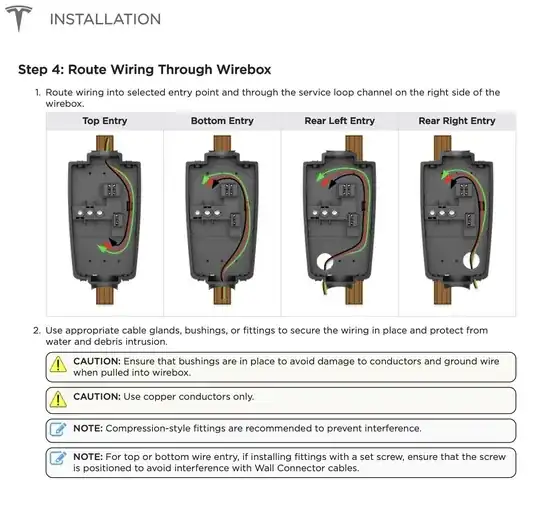

I’ve gathered, Tesla Wall Charger Terminal Blocks support 12-4 AWG (3.5 - 25 mm2), copper only, 90C-rated conductor (and the installation manual cals for the conduit with no mention of other methods) enter image description hereenter image description here

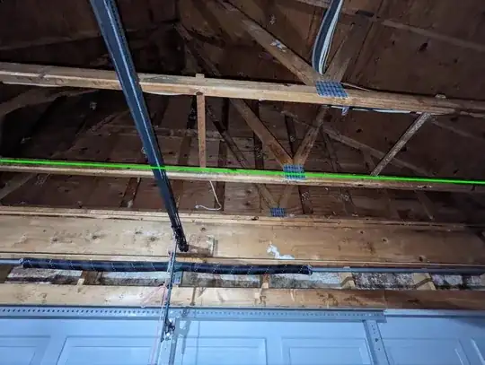

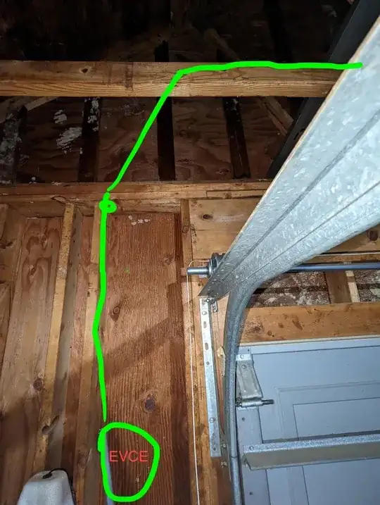

Ideally, I would like to install the EVCE on the left side of the garage door, (across from the electrical panel), about 20’ away. This way when I reverse the car into the garage I wouldd have the charger on the driver’s side for easy access. enter image description here
Based on my research, I believe I have these options:

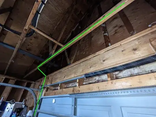

  1. Green markup - 4 AWG NM-B from the top of the panel. Run cable across ceiling joists by using the sides of existing braces then down alongside and centered on studs, drilling holes through blocking as close to the framing as possible enter image description here enter image description here enter image description here
  2. Green markup - Same run but with a 6 AWG THHN in a conduit

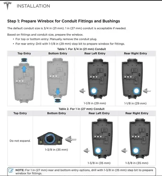

EVSE has indentations for both 1 3/8" and 1-1/8". I don’t have any experience with conduit and don't have a bender and would like to avoid buying for a single project if possible but this solution seems to be more time intensive but cheaper in materials

I think conduit is a great plan. For a first time learner, I recommend EMT. Why? Because it's an "Erector Set" - everything comes apart and there's no waste, nothing is glued so everything can be reused. It's also a viable grounding path, but not to a plastic case EVSE and we need a ground wire in the pipe anyway for conduit fill reasons.
I would use the green route, not the yellow route, because I disagree with opinions that Romex doesn't need protection there. It obviously does; the wall is being used to hang tools.
I wouldn't worry about hanging a junction box behind the EVSE. Just bring conduit in top or bottom. To step down from your conduit size to the EVSE's opening, just use conduit reducing washers e.g. this. The EVSE has a plastic box; it's not carrying ground so the reducing washer is just there to keep fingers out pretty much.

I would use the green route, and use "sweeps" to make the turn from vertical wall to horizontal. Where horizontal meets horizontal, I'd use either an LB or just a 99 cent 4x4 junction box (cheapest conduit body). Wire count and box fill aren't a consideration if there are no splices.
Conduit must be built and anchored total and complete before any wires are pulled into it. This is much easier, believe you me and it also allows you to do the work in sections. I'd build up the wall from opposite ends and let the pipes tell me where they want to meet.
#6 THHN is 65A. Both can be black. It's technically possible for two #6 THHN to fit in 1/2" conduit with a #10 ground, but that will leave literally zero room for the signal cable if you want to use the power limiting feature with the current transformers. So I would go 3/4" conduit. NEC rules don't allow the signal cable to run outside the conduit for reasons I won't get into here.
