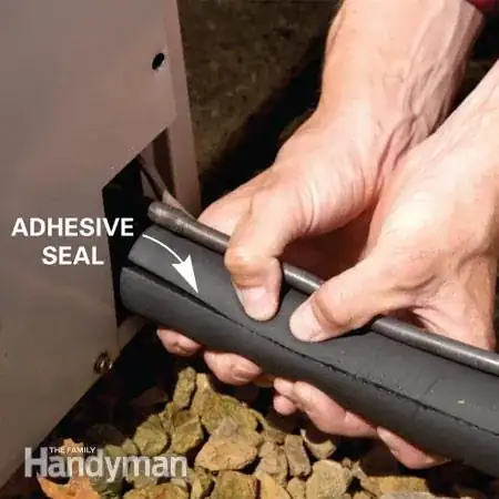

Any cool pipe in a basement will benefit from condensation reduction through insulation. Running a dehumidifier will also help. I have mine piped with a cut-off hose right over to the floor drain, and then connected to a right angle barb fitted with a 1" piece of hose going into the drain.
Hot water pipes will also benefit.
The closed cell (polyethylene) foam with the adhesive strips (covered by a pull-off protection strip) will last much longer and insulate better. You may still need an overlap wrap of tape at the butt joints. The open cell will work, but needs tape along length and is "crumblier".
Closed cell foam with adhesive
Open cell, no adhesive
