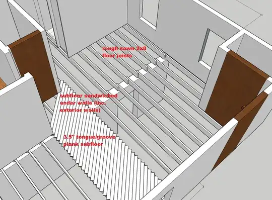

  1. Foundation wall in basement
  2. 2x8" floor joists overlapping at foundation

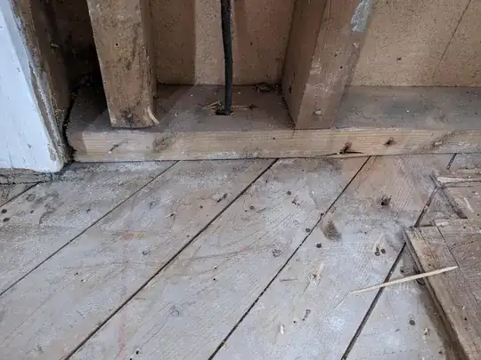

  3. 3 1/2" x 3/4" tongue and groove planks as original subfloor (sandwiched under wall plates) at 45 degree angle

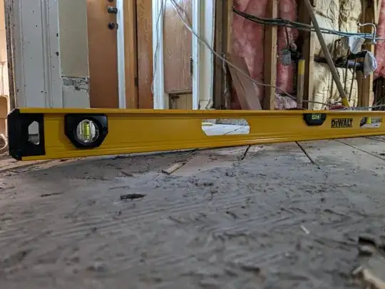

The new flooring I want to install is LVP which requires a very level subfloor. I don't think that the current subfloor will cut it, as there are hills and valleys all over due to inconsistencies in the rough-sawn floor joists, and settling over time. The maximum deflection isn't massive, perhaps 1/2" between the high spots and the low spots. However, the rate of deflection is quite rapid, as shown in photo 2. You can see the old mortar that someone tried to use to level the floor before placing plywood underlayment and tile (now removed).

  2. Is it recommended to leave the sandwiched subfloor underneath the wall plates? (Photo 3)

For #1 it will depend. If the joist is a constant 1/4 to 1/2 inch difference, a shim of similar size will work or if just a few small sections. If the joist is wavy then a sister will work better.
#2 I would leave/cut them near the wall. Cut at joist. It would be hard to find the same thickness wood today and much unneeded work. It is holding up those walls.
