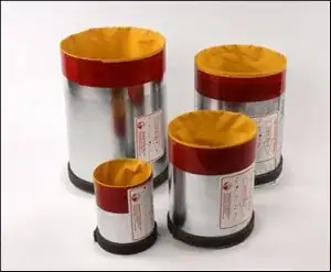

I did this setup and would NOT recommend it. I have an 80cfm panasonic in a small bathroom and a 110cfm older fan in my main bathroom. I used the same dampers shown above, the cloth ones. Plus each fan has its own damper built into the housing. The run is only perhaps 6ft total and I ran two 4" into a 6". When both fans are running at the same time (both taking a shower) the smaller fan gets totally overwhelmed and cannot move enough air. I'm thinking about changing the setup so both run out the side with their own wall vent.

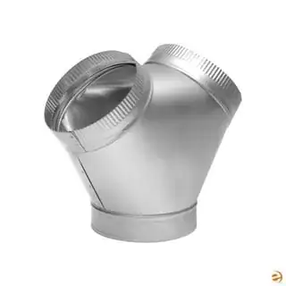

1 Y-Connector at the outside vent.
2 Backdraft Dampers (one on each leg) at the Y to stop the backflow of noxious gases from one fan(on) to the other (off).
Note that the backdraft dampers will add to the resistance of the duct work. You may wish to move up to the next size of duct.

None of the above solutions going to work.
That being said, the only plausible workaround is to install no fans in the washrooms. But run only the ductwork with a Y adapter. The ducting for each leg of the Y adapter to each washroom must be nearly identical. You can replace the fan opening with a grill for each washroom. Then add an 'inline fan' to the remaining leg of the Y adapter and run ducting to vent outside.
The above scenario will work provided the following: 1. When inline fan is in operation, air from both washrooms will vent out. 2. Both washrooms must have nearly identical square-footage. 3. Both washrooms doors are expected to be in closed position when inline fan is in operation. 4. Duct diameter must be identical for each leg of the Y adapter.
Folks, this is THE ONLY WAY. No other solutions exist nor work.

My suggestion is to use a mechanical damper such as ALDES. These dampers open with a very low pressure drop. I have always achieved good success using two to three Fantech fans installed in the attic (very quiet, and the ceiling plenum box operates under a slight vacuum) with the ALDES dampers vented out a 6" roof vent. They fit snugly inside the galvanized duct just after the fan. They are truly Cadillac dampers. The fabric dampers have not held up for me. The plastic dampers that come with ceiling mounted bath fans or those on Fantech fans just do not prevent air backflow well enough to tie multiple fans together.
Base on my air flow measurements the ALDES dampers has reduced the airflow only about 10%.
