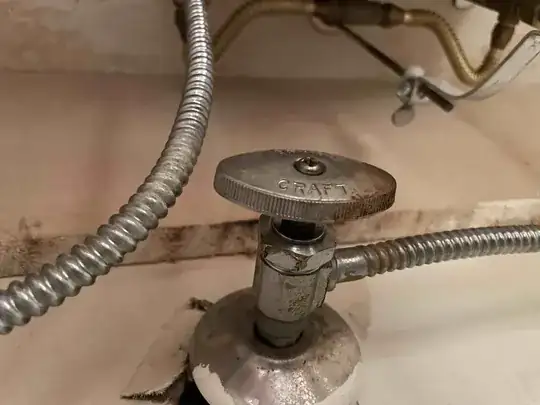

I am in the process of replacing faucet and concerned that existing supply line (see pic) may not make a water tight connection to new hardware.
Can someone give me more information about how this corrugated style supply works: any old manual or plumbing tutorial where connection to this supply line is taught?
My preference is to connect this line to another modern supply line such as braided steel type. How can I reliably connect these two lines?
I would like not to cut off and replace a brand new shutoff valve because I don't have a long pipe to work with. (The picture included is not the real one but from another sink not being repaired.)

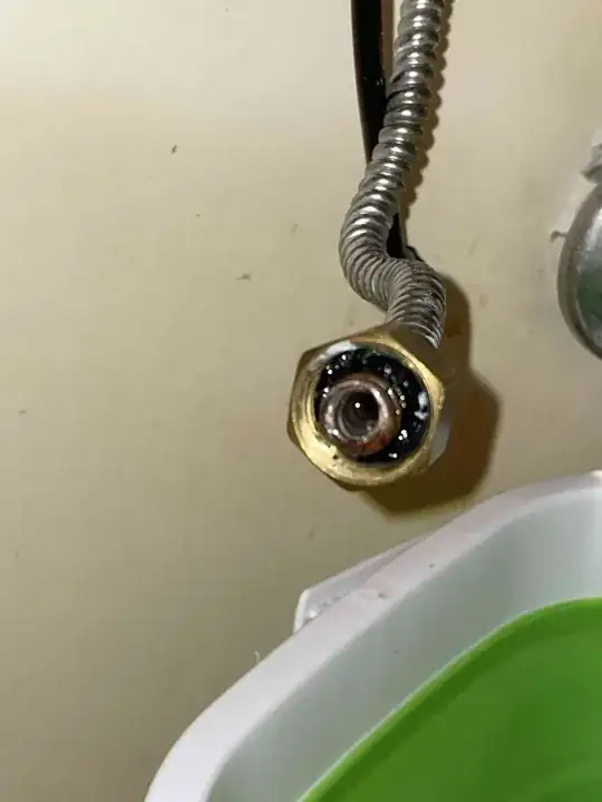

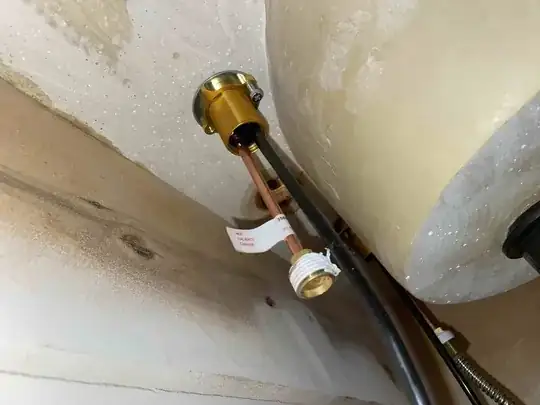

Here is the connection at the corrugated supply line and another from new faucet handle. My goal is to only connect these two lines.

I'll answer the actual question in a moment but do yourself a favor, cut off that valve, replace it with a new quarter-turn stop valve and a separate high quality braided supply hose. Just stop reading and go do it. No, really.
The valve is old, it'll need replacement, and I always say with an old valve like this, any time you're crouched down working on it is the best time to replace it. But the real problem is the hose, which is integral to it and cannot be separately replaced! So change both.
The hose, and the washer
That's a corrugated/flex supply pipe/riser. It uses an obsolete kind of compression fitting. You can still buy corrugated risers, but they have modern fittings. All kinds of modern fittings, you can even buy Sharkbite corrugated supply pipes.
Your old pipe does not have a special manufactured end, it just uses a compression fitting similar to the more common metal ferrule/olive that compresses against both the outside of a smooth pipe and the face of a fitting. To do that with a corrugated pipe you use a special rubber washer, either a top-hat shaped Step Washer that grabs the pipe and has a flat face for the fitting, or a Threaded Cone Washer that screws onto the pipe to make contact and mates with the fitting in a wedge shape. If you insist, they're easy to find with those search terms.
