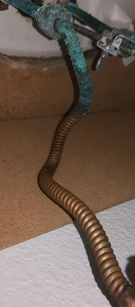

Pipes made of corrugated flex copper were popular about 30+ years ago, in particular they were used to connect stop valves and bathroom/kitchen faucets, as shown in the photo. Typically, one end was permanently attached to the valve outlet while the other had a standard threaded fitting. Due to their replacement by more modern types of connection, no much information is available online on the techniques that were used to cut such pipes to the needed length and to place the fitting right at the shortened end.
Corrugated copper pipe with fitting at the upper end

To make a connection within the corrugated portion of the line requires a clean square cut and a threaded cone washer along with a thin brass washer and a nut like your original. However, this type of connection is ancient, and those parts would likely be difficult to find. An old plumbing shop, along with an old salesperson who remembers how these types of connections were made 30+ years ago would be your best bet if you intend to try it.
These lines are not designed to be soldered; the material is very thin and they are often 7/16" O.D. and do not (easily) correspond to modern tube/pipe sizes. Epoxy putty is not a normal acceptable practice in plumbing supply lines, regardless of the availability of products that might claim to work for that.
As suggested in the comments, you really should replace the entire line with a modern flex supply line. If that corrugated line is an integrated part of a stop valve, both the valve and flex should be replaced.

You could try using a modern copper flare tool, and associated fittings, from automotive (brake line), A/C (refrigerant line), healthcare (gas, vacuum). These are all available on line. This won't be exactly how it was done decades ago, but if the flare tools don't break your thinner pipe they are very similar in function, they are just designed to match modern fittings so hopefully will produce a good seal.
