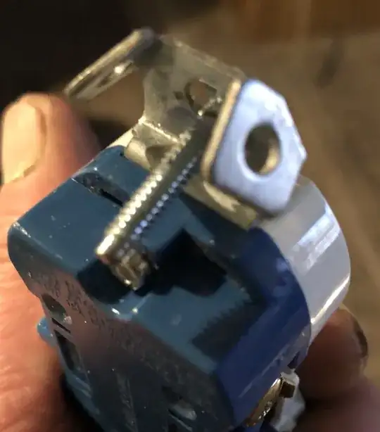

(https://i.sstatic.net/cU5SW.jpg)
I have not been able to find this solution to (shim...space...) keep an electrical outlet away from the wall,
So it can sit ABOVE new tile... ( ie: kitchen backsplash) The tabs on both sides of the outlet mounting screws can be bent back like “dog ears” therefore allowing the outlet the spacing needed for install after tile.enter image description here
