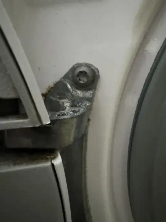

Our washing machine (Logik L712WM20) door glass broke and I’m trying to replace it. However I don’t know what this screw is.
Does anyone know what the screw is and what tool I need to remove it?
That's a Torx head, you'll need a Torx screwdriver or drill bit for that. Hard to tell what size from your photo, maybe T25 or T30 at a guess. Easy to find at your local hardware store.
Sometimes you can turn them by wedging a regular slot screwdriver in there, but tricky if it's tight and might damage the screw or driver.
