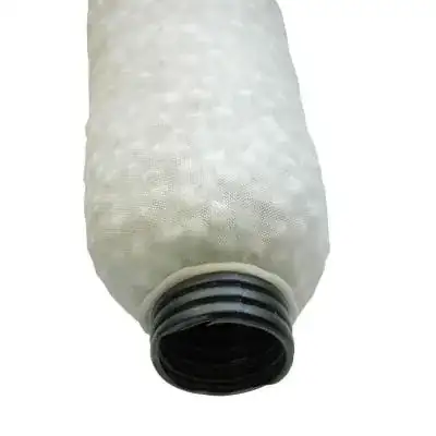

There are many French Drain videos on YouTube. My opinion is watch the ones by French Drain Man for commercial grade work that lasts. Apple Drains great also for homes in the South where freezing is not an issue. The filter wrap over pipe is controversial as it substantially reduces flow. FTM puts it outside the gravel to prevent silting. The prefab DIY stuff surrounded by Styrofoam peanuts is not used by Pros and uncertain.

Depending on the area , and your costs, you could also just buy a prefabricated french drain and save yourself some times. Your BIG local hardware store would have something like this:
