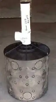

You could also buy a small leach pit, but this might be overkill for your situation.
You'll bury this in the ground surrounded by 3/4" - 1 1/2" crushed stone, then connect the AC unit drain to the lower inlet pipe (the upper pipe is a vent). Before you drop it in the hole, remember to remove the small hole knockouts (to allow leaching). This will require a larger hole, and again may be over kill for your situation.
