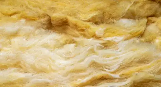

Maybe the reason is not the heater, but insulation that just got worse performances because of remaining humidity. glass wool
It could be possible if the insulation is made with glass wool (if this is P.U., P.S. or wood wool that won't be normally affected by humidity) ; there is actually a lawsuit between french industries that revealed that under high level of humidity, glass wool insulation could lose up to 75% of its properties.
I could not quickly find an english reference about the lawsuit, except of these kind of imprecise articles (fr) [https://www.soigner-l-habitat.com/actis-vs-st-gobain-pourquoi-la-laine-de-verre-a-perdu-son-proces/]
