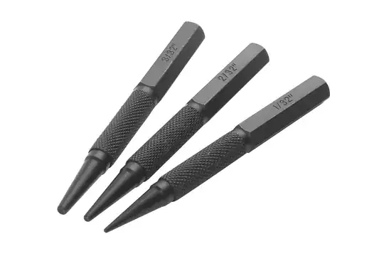

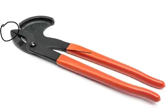

Crescent makes descent nail pulling pliers. To get it to fit tight against the wood I ground the pliers end flat and rounded the edges to roll better. Use a nail-set to punch the nail further into the wood, breaking any glue that might be holding the nail to minimize potential for breaking, then use the pliers to pry the nail out through the back.
Crescent nail puller

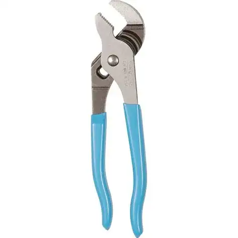

+1 to RG Hughes answer showing a tool that I wasn't even aware existed but a very similar tool that many people are more likely to already have and is my go to for removing brad nails are channel lock pliers. You can use a scrap piece of wood/plastic/other material to both protect the bookcase from damage and provide additional leverage like the round pivot point on those dedicated pliers does. The longer handle that channel locks typically have allow you to apply a tremendous amount of squeezing force that helps grab onto the nails although it's still very easy to just snap them in half when pulling from hard materials.

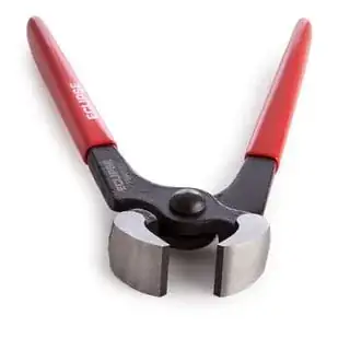

Pulling through the back with tile nippers is my go-to strategy, but sometimes doesn’t work with mdf (as opposed to wood). In that case, you can try bending them back and forth on the back side; oftentimes, this will break the brad below the surface.

I recommend cutting them from the back using either end nippers or side cutting pliers. If you use small versions of these tools, you should be able to get to about 1mm poking out which would disappear upon reassembly.

A channel lock can be a very good alternative, and I've definitely used it for this before, but the jaws may not align well enough for some small nails. I have at least one (cheap) channel lock that wouldn't work for this. Even a pair of regular pliers may be good enough for a nail this small.
