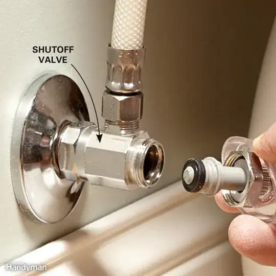

I've seen the water look dirty and black-ish for a few seconds, many times after using a multi-turn shut off valve that has an old washer.
The washer itself starts to break down, when you use the valve and squish it closed it washes the "black stuff" (from fine powder even up to little bits of washer) out the faucet when it's turned back on. Eventually the washer will be so bad it won't shutt off the water too, and I wouldn't really want to drink water that has breaking down washer residue in it anyway.
Here's an image of a multi-turn shutoff valve with the bonnet nut and stem removed, showing the washer at the end: enter image description here

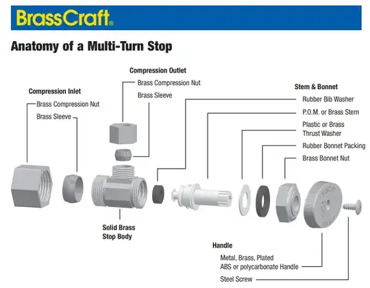

And another image with all the parts labeled: enter image description here

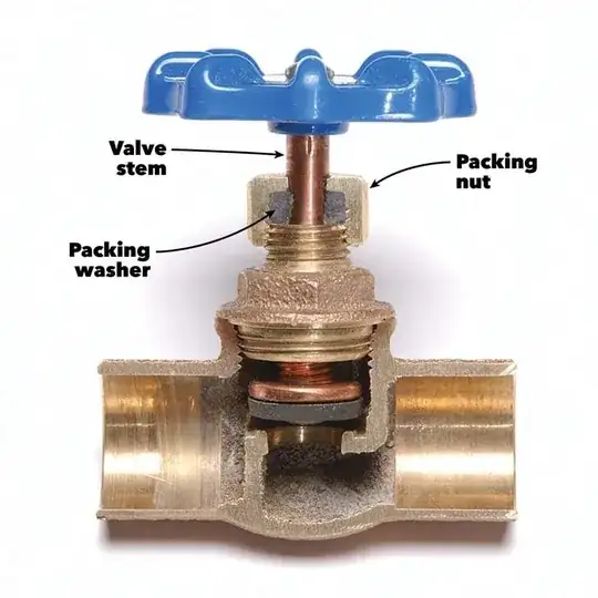

And another picture showing a different type of shutoff valve (globe I believe) that also uses a washer: enter image description here
The washers are fairly easy to replace too (there's usually a stem valve washer / bonnet packing in there also, or a string type packing on the older valves), if the valve will come apart and isn't corroded solid. If so, I would highly recommend just changing the washers and internal parts instead of putting on a whole new valve (wrestling off an old damaged compression nut and cleaning the pipe is NOT worth it when a new washer takes about a minute).
For example, BrassCraft sells a Multi Turn Stop Stem Repair Kit BCSR01 for their multi-turn shutoff valves, although the kit is about 70% the price of a whole new valve. Or the washers alone are available from a few places, try a web search for BrassCraft Valve Bibb Washer for Stop Valve
