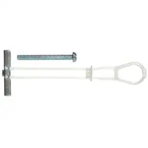

There is an anchor that has similar characteristics to a toggle bolt, known as a toggle anchor
toggle anchor
These have a long straps holding the metal backing toggle. The straps are slid out of line to turn the toggle parrallel for insertion in the hole. Then the straps are aligned to turn the toggle perpendicular. The outer collar is slide along the tracks to the face of the wall and the excess straps are broken off.
This has a significant advantage over spring toggles because the bolt can be removed without losing the toggle.
