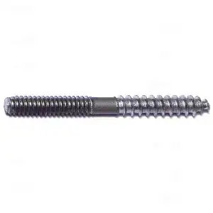

In wooden framing, an alternative to regular screws are hanger bolts that can be threaded into the studs and leave a bolt on the outside of the drywall for hanging the object.
hangerbolt
The advantage of hanger bolts is the ability to easily remove and reattach the load using a nut or wingnut.

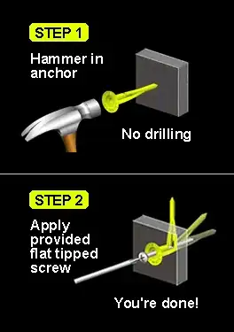

Since you don't have a drill, perhaps consider these metal hammer-in plasterboard fixings. They're designed for plaster, but I've used them to hang a coat rack on drywall and they worked perfectly. They also have the benefit of less damage to the wall if you eventually pull them out. They come in varied weight ratings, so be sure to buy ones big enough for your project.
The WallClaw Drywall Anchors operate similarly - no drill required - but I cannot speak to their performance.
