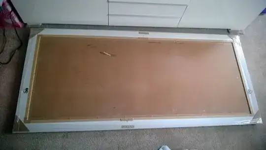

I would like to hang this fairly large framed picture on my living room wall. The frame measures 167x75cm, and weighs roughly 8.5kg. Both top and bottom of the frame had snapped previously (while being transported from abroad), and have recently been repaired by a local framing specialist. Here is a photo of the back of it - you can see the 4 metal braces where the repair took place:
back of picture frame
The wall it needs to go on is a 9mm plasterboard with 30mm insulation board on top. As you can see in the photo the frame already has two D rings fixed to the frame for hanging from two hooks.
I would like to put any fixings into the studs which are 400mm apart. Unfortunately to get the picture in the centre of the room, both D rings fall more or less halfway between studs.

Also should I worry about the stability of the frame at all after the snap and repair? The braces look to be strong but I suppose the frame still won't have its full original strength?

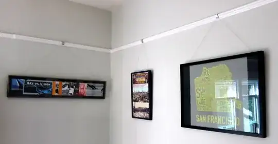

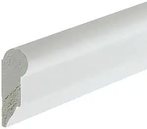

Picture Rail
Picture rail is a type of molding that is installed around the top of the room, about 7-9 feet above the floor.
Picture Rail

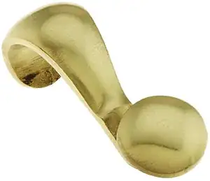

You then use picture wire, and picture rail hooks to hang pictures. Many different types of hooks can be found, from very basic to ornate.
Picture WirePicture Rail Hook

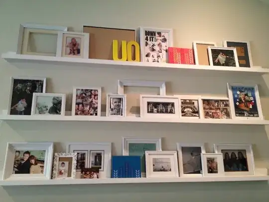

Picture Ledge
Picture ledges are also an option, and come in many shapes, sizes, and styles. They can even be custom made, to suit your style.
Picture Ledges

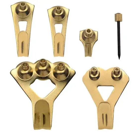

I would strongly recommend Ook type hooks
ook
The heavy duty versions can support up to about 100 lbs.
If the surface is not as solid as drywall, consider using anchors with hooks attached. A discussion of various kinds of anchors can be found here.
