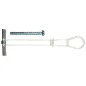

If you have not damaged the area too much, you may be able to replace the drywall anchor with a strap toggle type anchor.
toggle
The legs on this anchor slide to move the crossbar parallel to them. The crossbar is slid into the hole and the legs are then adjusted so that the crossbar is now perpendicular (but parallel to the inside surface of the wall. The front plate on the toggle is then slid tight to the wall and the extra legs are snapped off. The hanging item is then secured by a bolt that goes through the crossbar.
If the hole from the original anchor is much bigger than the toggle diameter, you probably need to patch the hole and move to a different, sound section of the wall and start again.
