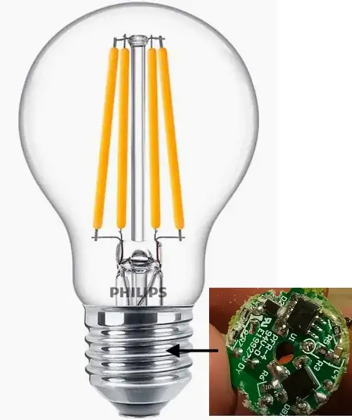

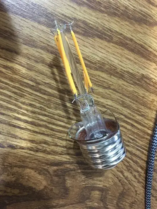

I found this lightbulb to be perfect. However, when I unscrewed it to read the label, it fell on the ground and broke!
What kind of lightbulb is it on the inside? Incandescent, halogen, flourescent, compact flourescent, LED, or something else? If it's LED, why are the LED rods shaped like that? And what are the keywords to find a similar bulb?
There is also a small circuit board inside the bulb end that I forgot to photograph.

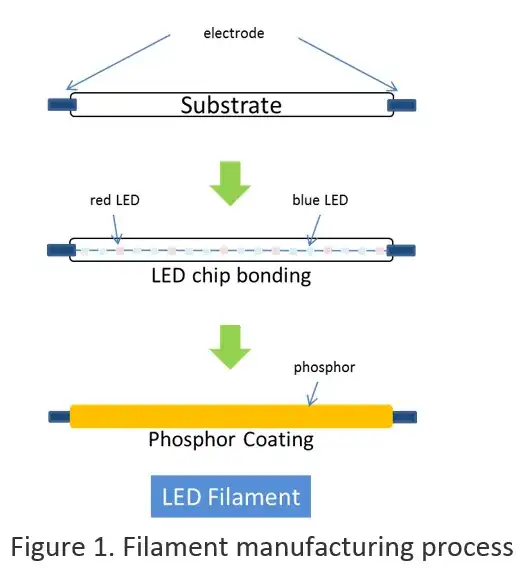

This is a LED filament bulb. The yellow rods are actually strings of blue LEDs mounted on an insulating substrate and coated in a phosphor than converts blue light to white.

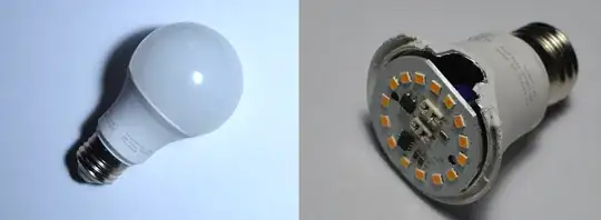

Compared to a standard lightbulb like this one:

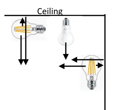

  • Light pattern is the opposite of a standard LED bulb: it emits more towards the sides, whereas the standard bulb emits more towards the top. This makes it better for some uses, worse in others. Usually for wall or ceiling fixtures it is better, because the bulb is mounted parallel to the wall or ceiling. For a pendant or desk lamp where you need the light to come out more like a spotlight, standard would be better.
Arrows indicate direction of highest light output with bulbs in the best orientation according to their type:

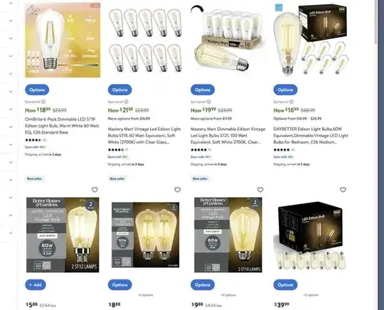

This is simply what is marketed as a "Vintage light bulb." That's all there is to it.
You can instantly find these anywhere that sells bulbs or instantly see them for sale online.
If you simply google nothing more than "light bulbs" you will see many of these (incredibly stupid) "Vintage Style" light bulbs:
