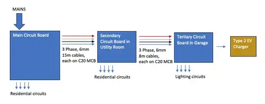

I have an old house which has had extensions progressively added over 100 years. I cannot wire any cables directly from my main circuit breaker to my garage. Ideally I would like to install a Type 2 EV charger to the circuit breaker that is already in my garage. Note - I will not be doing this myself, I am just looking for advice on what I should be expecting to hear when I contact a professional installer.
I am concerned because the circuit breaker in my garage is already behind 2 layers of MCBs so I dont know what current or KW charging capacity I should be expecting from the charger installed in my garage.
Hopefully the image is self explanatory with all relevant info (?).
What rated EV charger should I be installing, and how, if I want to maximise charging?

Your maximum will be the capacity of 6mm2 wire
or probably 32A.

Your service is fairly modest, and your charging plans extremely ambitious. Also, you are unwilling to fund running cabling from the main service panel/consumer unit to the garage. That forces us to use the existing feeders, which fortunately are 6mm2 and 32A even under the most conservative rules. I don't know why they are 20 amp breakers - this is something you can address with the electrician to open up that pathway to at least 32A. Whatever that is, that constitutes your charging limit.

And this is why we are forced into a particular technology - EVEMS. This places "CT" current meters on the main supply wires from the utility. It is monitoring the current draw of all loads in the house including EV charging. It then communicates with the "charger" (which is not a charger at all) which then adjusts charge current dynamically to prevent the house's electric service from overloading.
Normally I would link Technology Connections' video about letting go of range anxiety and install a more modest system, but given the limitations of your house, I think we are forced into this technology. So we might as well make the most of it. Note that high-power EV charging is by far the most demanding load a house will ever face. So it is also the most unforgiving to even the slightest flaw in an electrical installation. You have been warned.
Because of your "no cables" prohibition, we are forced into the Myenergi ZAPPI for the charging station, which calls this feature "Grid Limit". This can partner with a power meter called the HARVI, which can communicate with the ZAPPI via radio link (solving your "cannot run a wire" problem).
Mind you, I have not kept up on the latest European product selection. It's possible someone else has an EVEMS capable station with radio link to its power meter.
The grid limit will need to be set to the MINIMA of your electric service from the utility, the capacity rating of every wire and circuit breaker and equipment enroute.

6mm² is for circuits up to 55A. That's the max current you will be able to push into your car through the existing path. (or up to whatever breaker is present in the main panel protecting that run).
You may be able to upgrade the cable from the main panel all the way to the garage panel, that will increase the max current.
Any EVSE for domestic installation can be set to limit its current based on the breaker that feeds it, so the specific model doesn't matter as much.
There are smart EVSEs that use current sensors that attach to the feed of the panel to make that current-limiting dynamic. Though those usually are set to measure only a at a single point. In your case it seems best to make that measuring point single point the utility room panel.
With that dynamic current limiting you can maximize charge rate while not overloading the circuit.
Though you will want to check your car and cable to see if it can actually pull that many amps, either can be a bottleneck.
