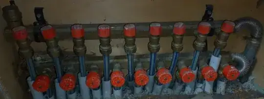

The underfloor heating system works great, but never had any thermostats nor actuators. As a result, temperature regulation of the individual circuits is entirely manual and approximate.

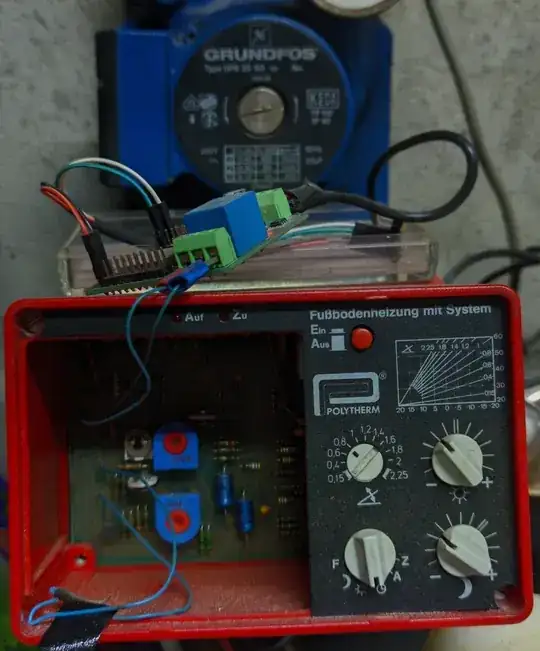

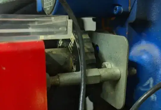

A Polytherm controller manages both the circulation pump (on/off) and the mixing valve (open/closed, modulated). It monitors the water temperature through a sensor attached to the pipe going up.
An ESP32 relay module was put in place of the analog clock that broke many years ago.
Heating controller Circulation pump Mixing valve

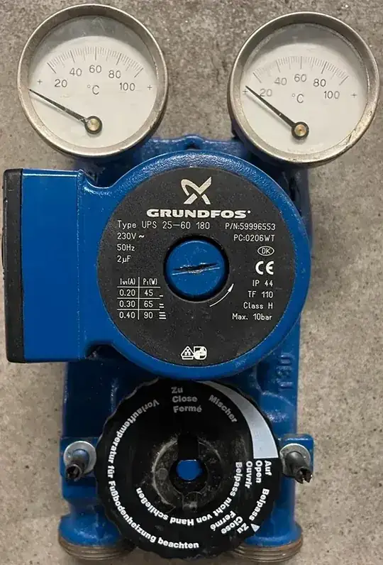

I'm pretty sure the hardware listed above should cover everything except for the mixing valve, which I'm honestly uncertain how I should deal with.
In theory if I set the boiler temperature correctly there should be (almost?) no need for the mixing valve to be actively regulated. Can I just keep it manual, perhaps with a temperature sensor to be used as a high temperature alarm?

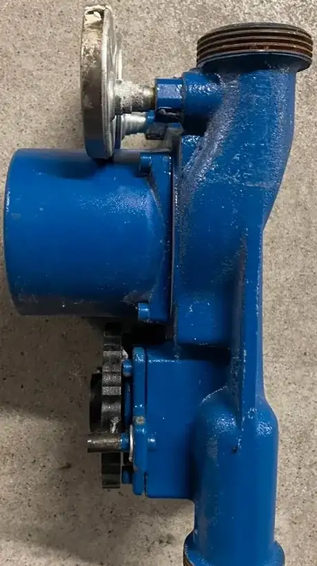

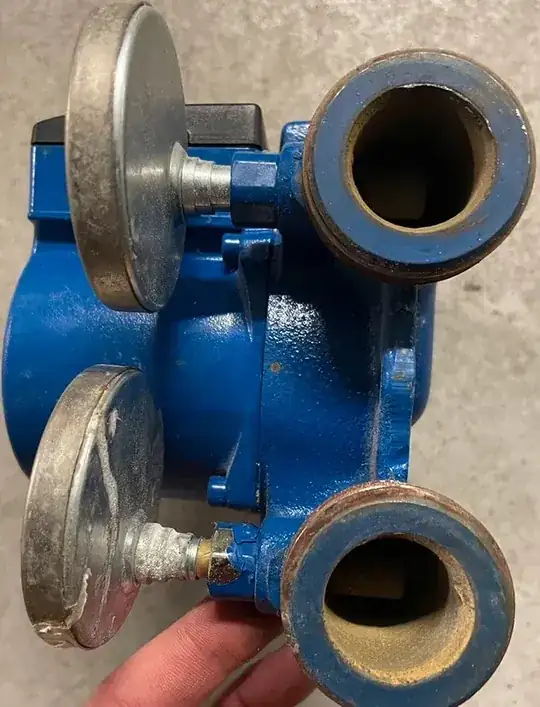

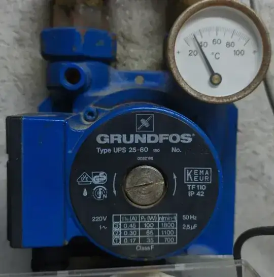

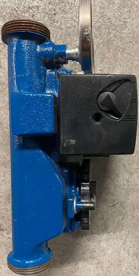

I found a few pictures online of the full circulation pump + mixing valve block:
Pump block front Pump block left side Pump block right side Pump block top
