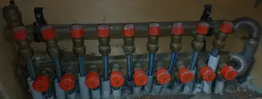

Heating circuit
I purchased a single HmIP-VDMOT to check if it could be mounted on the valves that are installed on my underfloor heating system. Unfortunately the adapter that is provided, which is allegedly for a M30 x 1,5mm thread, is too large.

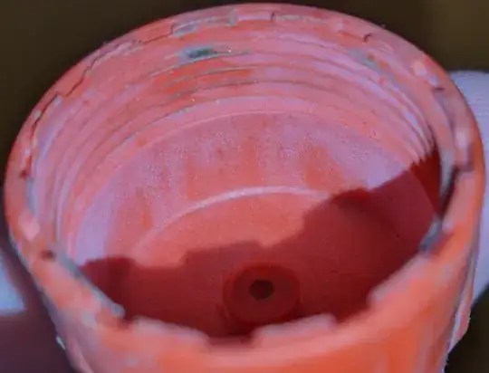

Here's the valve's cap interior:
Cap interior

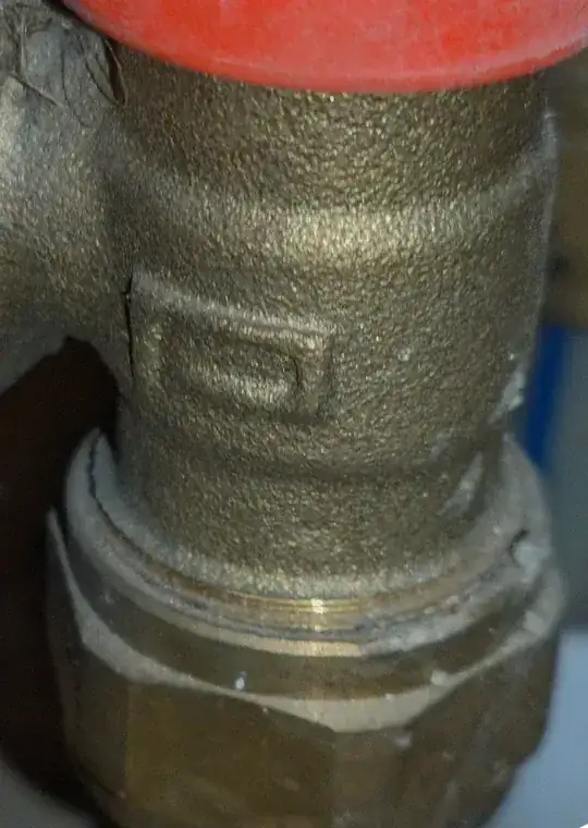

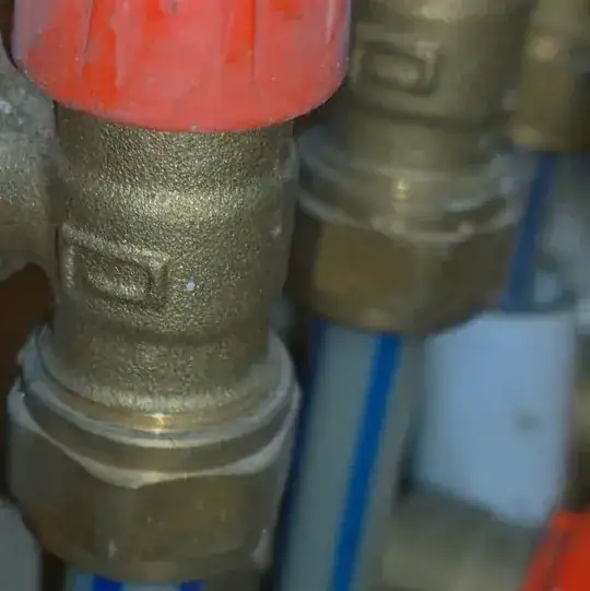

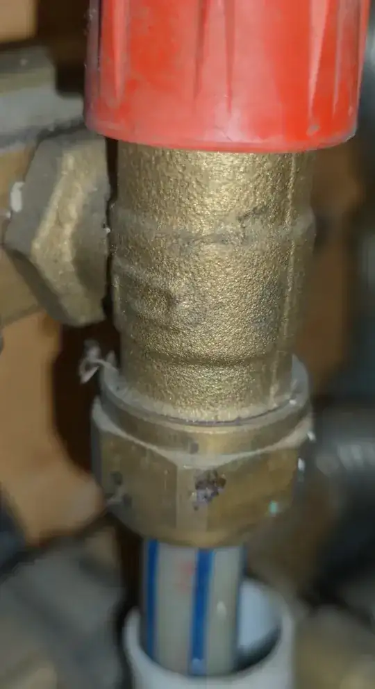

There seems to be the same symbol on each valve, leading me to think it may represent the brand:
Valve symbol Valve symbol Valve symbol
Is it possible to identify the valve based on that? Can I use calipers to measure their thread?
