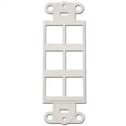

I used a single, recessed, dual-voltage wall plate that lets you do your media and power cables all in one plate. You just buy an "old work" electrical box, wire it up, and attach it to this plate instead of to the drywall.
alt text
I used 6-port keystone plates for the media ports, so I could put just the ports that I wanted back there, and even customize it easily later, if needed.
alt text

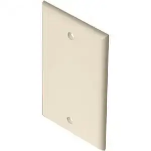

The best thing I can think up totally as a DIY without requiring real hard-wiring would be to get a blank faceplate, and put a square hole in it, and then mount an IEC 320-C14 connector in it (eg. from digikey).
alt text
alt text
Then you can just use a standard C13 cord (like the kind used to connect most computers, TVs, etc) and plug it into a surge protector or UPS or whatever.
