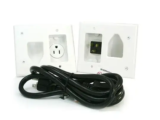

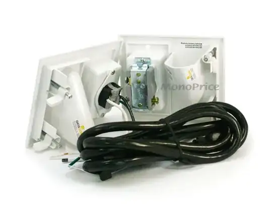

Monoprice has a complete kit that will allow you to cut two holes in the drywall, and then get power and also run your signal cables vertically. I believe you need to install an 'old work' (aka 'retrofit') box for the power side, but that is pretty straight forward. front view
Once you cut the holes, these things fit in, and have wings that tighten down onto the drywall. rear view

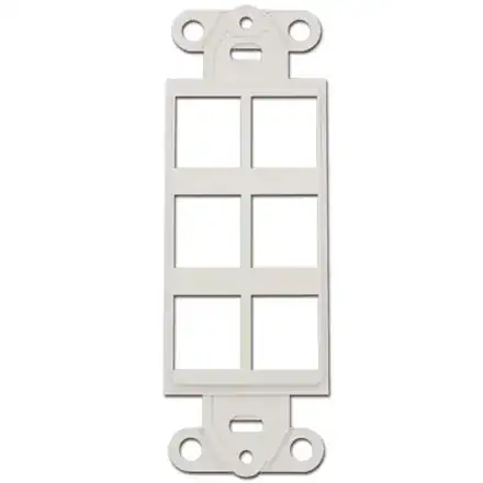

You wire up the power using a standard electrical box, but it fits better behind the TV because it's at an angle. You can also use whatever wall plates in there that you want. I like the flexibility of the Keystone system, so I used a couple of 6-port Decora Keystone plates, so I could put in both coax and component video and RCA audio, with room for expansion if I ever decide to run another device to the TV.
