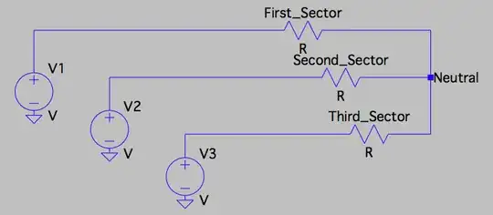

I'm not sure how your installation was made, but since you have 3 different phases distributed through the house and you have voltage in the neutral what makes sense to me is if you are using the same neutral for different phases. I'll illustrate it:
If you have the same equivalent resistances (or same amount of power draw) being used through the 3 sectors of the house you the neutral will be equal to ground (very near).
If you don't have nothing connected, the neutral should be at floating point (near cero)
If the resistances of the house (or power draw) aren't the same at some given time, the voltages will add as an AC Voltage in the neutral line. Resulting in lower voltage in one sector of the house and over voltage on the other. Normally you have over voltage in the sectors of less power consumption (TVs, PCs) and lower voltage in sectors of greater power consumption (boilers, etc).
What you need to do (or I would do) is make the neutral lines for each phase independent, using ground rods.
ps: I'm not an expert.
