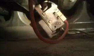

Here's what the pilot assembly looks like:
Carrier 58GS Pilot Assembly
Click for larger view

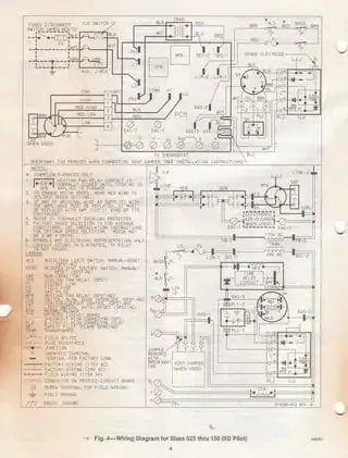

Here's the schematic for my setup:
Carrier 58GS Wiring Diagram

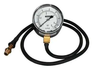

Gas Pressure
I started by measuring the incoming gas pressure using a gas pressure gauge. I found it to be 6 WC (inch water column), which is well within the acceptable range specified on the furnace.
Gas pressure gauge

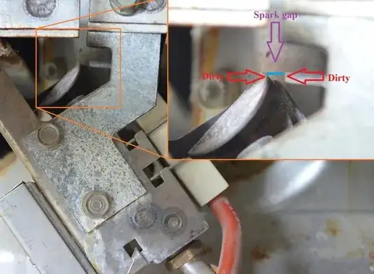

Dirty Gap
Next I took a closer look at the spark gap itself, and watched closely as the spark was generated. I even recorded the spark with my video camera, which allowed me to zoom in fairly close. This is when I noticed a bit of carbon buildup on the electrodes, and wondered if it could be that simple...
Cleaning the Gap
I grabbed a bit of 220 grit sandpaper, and cleaned the electrodes up a bit. steel wool is probably the tool of choice for this job, but I didn't happen to have any on hand at the moment (not yet unpacked).
Success!
After testing the pilot ignition a few times, the problem seems to be fixed. We had a cold night last night, and the furnace fired up fine all night. As I write this, the furnace has just cycled successfully yet again.
