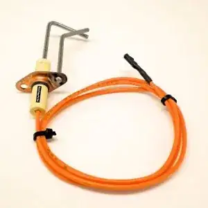

Spark Ignitor
A spark ignitor looks like this.
Spark Ignitor
Take notice of the thick, often orange or red wire that is typically used to connect the ignitor to the ignition control module. This device works by generating an electrical arc between the two probes, causing the pilot gas to ignite. If there is no spark, you'll have to replace the ignition control module and/or the ignitor itself. If the ignitor is not igniting the gas, but there is a spark. You can try cleaning the electrodes with fine steel wool, to remove any carbon buildup.
