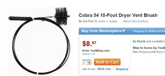

I use a dryer vent brush like this one at Wal Mart:enter image description here

I took it all apart and began using the lint brush as shown in another answer, and it worked OK, but much of the lint was caked on to the point I had to scrape it off with a hard tool (screwdriver).
In the end, I went out and purchased a brand new 10' section instead, and then put it all back together with proper metallic tape. Dryer works much better now. I figure with an annual check I should be able to keep it fairly clean.
