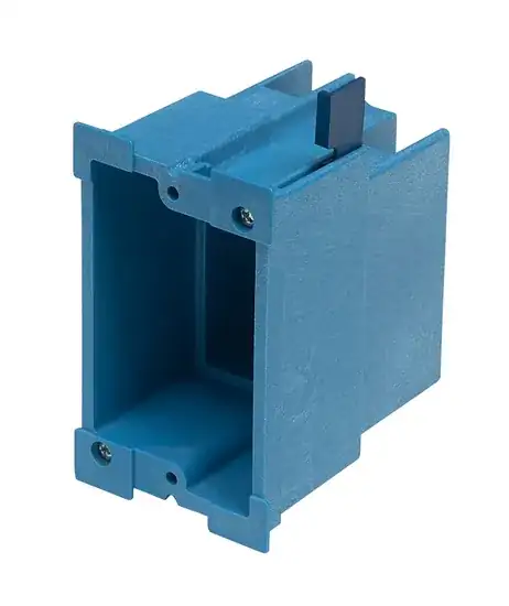

This is kind of going the other way from what you are asking, but have you considered putting a "remodel box" like this "Super Blue Hardshell" box from Carlon:
alt text
and then putting a cover on it, possibly with a blank faceplate or a coax terminal? You would end up cutting a larger hole, the size of the box, then you push the box through and turn the screws to lift up the "flag" (dark blue in the photo above" and pull it towards the drywall from the back to secure it in place.
If you don't have any interest in having coax in these places, perhaps the coax could be used to pull Ethernet network wiring or something else that you'd find useful in these locations?
I did this when we moved into our house, to bring Ethernet and phone to places where we didn't have it before, and these boxes look very nice when done. It looks like any other electrical or phone outlet you'd have in the house.
You can get modular faceplates with one or multiple holes to mount various networking, phone, audio and video cables in, for example this coax/HDMI/Ethernet example from Wisdom Electronics:
